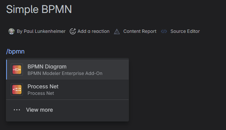

Now about your question. If you have an existing .bpmn file, you can add our app to a Confluence page by using the "+" button in the top navigation bar or by typing "\" on the page. Then search for our app by typing "BPMN".

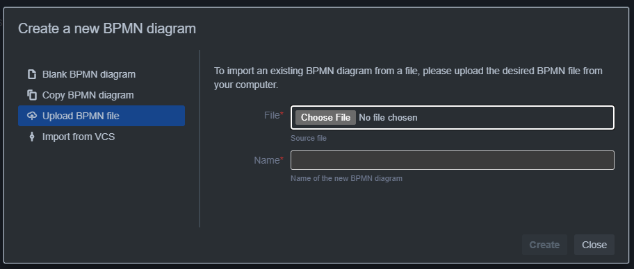

Once you have added our macro to the page, a dialog should open, which allows you to upload a file stored locally on your PC.
I hope this helps?
