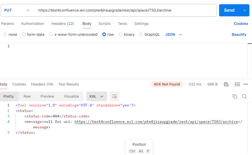

Thank you for your quick reply. Indeed, all the endpoints work perfectly except for the "Update Archive Space" endpoint, which returns a 404 response, as shown in the screenshot.Capture d'écran 2024-11-07 133007.png

The REST API doc says that 404 is returned if:
Returned if there is no space with the given key, or if the calling user does not have permission to view it.
 Are you sure that the user account you use for the request has the permission to archive that particular space? (Can you archive the same from the web UI logged in with that account?)

Hi, Yes I have admin account and I can both archive and restore any space. I believe it is a version mismatch since I didn't find the endpoint you shared with for my current Confluence version.
