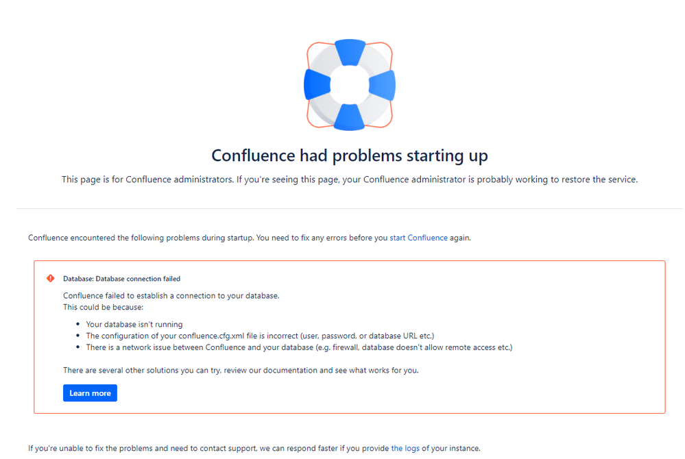

I installed this product on my personal server a few years ago.
Recently, I tried to connect to my personal server confluence and move to the cloud, but I can't connect to that confluence.
I can't connect even if I turn the server off and on again.
How can I move my confluence files to the cloud service?

Hello Kim!
Thanks for including your config file and a screenshot of the error. Everything I'm seeing is pointing to the H2 database (which is meant for demo/trial use) is not available. Further information on the H2 database can be found at Embedded H2 Database.
You might be able to attempt a recovery of the database, this can be done using Startup check: embedded H2 database read-only.
Alternatively, you might have to restore a backup to a new instance of Confluence into a database that is not H2. For that, we suggest Restoring Data from other Backups and to migrate to a new database can be done at Migrating to Another Database.

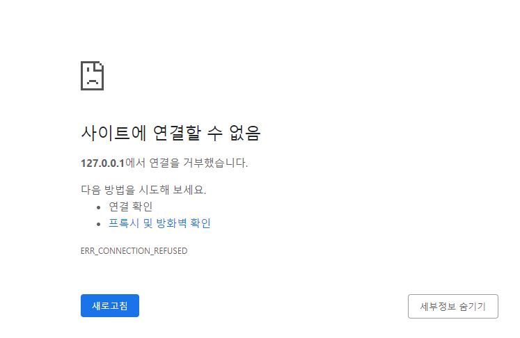

I'm following the method you taught me. I installed DB Visualizer and connected it using the backup home path. And I pressed Stop_service.bat in the confluence file. DBVisualier connected the newly created database. However, the following screen appears on the 127.0.0.1 site. I'm not using a proxy server. What should I do next1.JPG

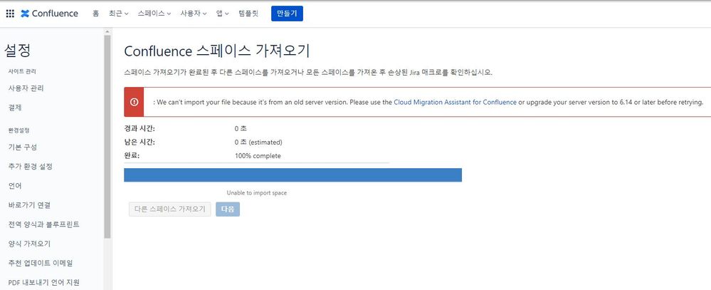

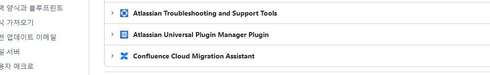

I tried the way you told me over the weekend. 1. I moved my personal server from the expired h2 database to Oracle. So I can access my personal server version now. 2. The personal server confluence installation version is 6.12.2. So I installed Confluence Cloud Migration Assistant. 3. And we did a space export. 4. The zip file was retrieved from the Cloud server.
The problem is that there is an error in number 4. What should I do?

Thanks for including a great amount of detail and your screenshots. Since you're attempting to import a backup into the cloud (vs using the migration tool), you'll have to either do one of the following:
  1. Install and use the migration assistant (Which is looks like you started)
  2. Upgrade your Confluence server to a higher version, take an export and then restore in cloud.
The easiest option is 1, from your notes it looks like you have this already installed but did an export vs using the app to migrate. Please review and follow the instructions listed here: Use the Confluence Cloud Migration Assistant to migrate.
If I am not understanding your steps correctly or if you're still having difficulty then please let me know.

June 16, 2021
Sure. I renew my Home server. but I can't access it.
I only see the web page like this.
Q. how can I see my log file?
