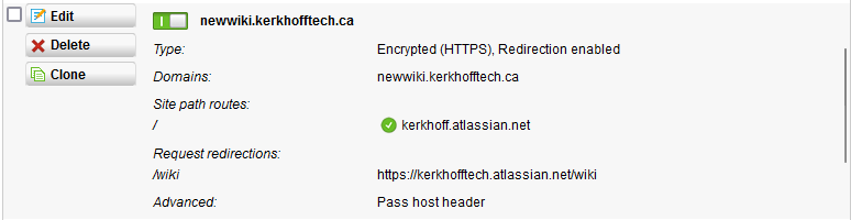

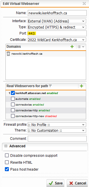

I set up the 301 on our Sophos SG:
I changed the DNS to newwiki.kerkhofftech.ca for the redirect so that our links to the old on premise Confluence wouldn't break before I got this working.

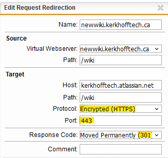

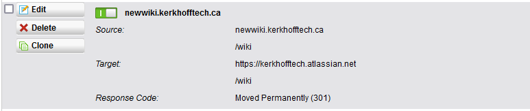

I am guessing here, but the behavior so far points me to this. Do you have a redirect for https to the new site? If you enter newwiki.kerkhofftech.ca into a browser it does redirect, but just to https://newwiki.kerkhofftech.ca. Then it just stops. See if you can redirect by setting the source to specifically https://newwiki.kerkhofftech.ca to redirect to https://kerkhofftech.atlassian.net

The redirect is specifically https
