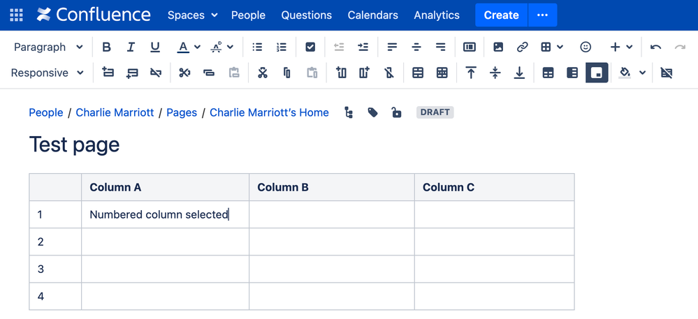

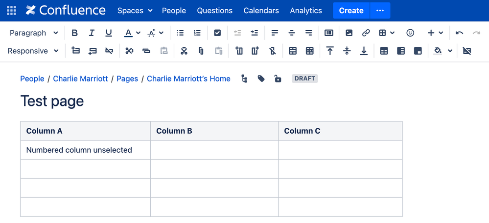

Have you tried toggling the numbered column setting in the toolbar?

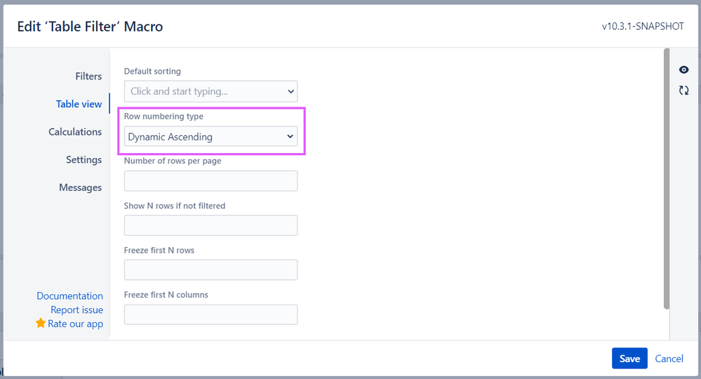

The standard "Insert numbering column" icon should be displayed no matter if your table is a separate one or wrapped in other macros (Table Filter, Table Transformer, etc.).
If you navigate to this icon and see that it is not active (the standard numbering wasn't applied) but you still see the numbering column and your table is wrapped in the Table Filter macro, it may mean that the numbering was created inside the macro.
You may go to the macro settings -> Table view tab -> Row numbering type and delete the numbering (leave the field blank).
