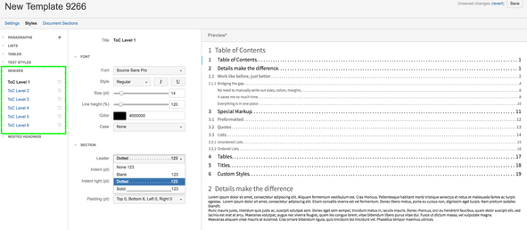

Had you considered using an add-on to export your content to PDF?
If this would be an option for you, our app, Scroll PDF Exporter, would be able to meet your requirements for creating a ToC with leaders and page numbers.
Our app wouldn't do this via the Confluence ToC macro but instead would generate a ToC automatically from your heading levels, through the use of a customizable template that you apply when exporting. The customization all occurs within the apps inbuilt WYSIWYG template editor (see screenshot).
If you used our app, you would be able to keep the ToC macro on your page but at the same time have it excluded from the export via a specific option that we provide prior to exporting. This would then allow you to simply include the automatically generated ToC with your own customized preferences in the export.
Let me know if this information helps – you can evaluate the app for free via the Atlassian Marketplace for 30 days.
Cheers, Thomas (K15t Software)

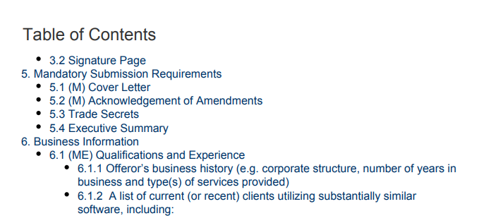

This is not confusing or hard. It is a matter of rendering dot leaders and page numbers to the right side of the page. I tried the pdf stylesheet commands and they would not render the page the way I need it. I am looking for actual printed page numbers - not section numbers.
This is how Confluence renders the PDF TOC:

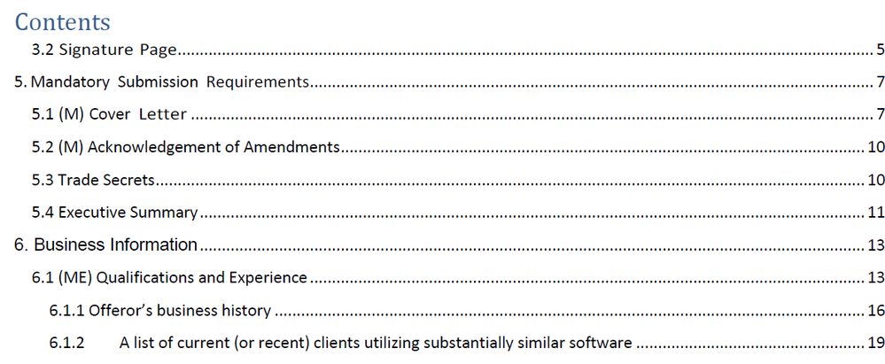

I had to save the PDF as word, create the TOC and save as PDF. This is doable but this is a complex document and when you switch from PDF to Word and back to PDF it creates other issues. I should be able to get dot leader and page numbers on a Confluence TOC this is not hard or complex. The page numbers are cut off on this image but they are there after the work around. My question is why do I have to go through all of this and create other problems in my document. This is not hard.
