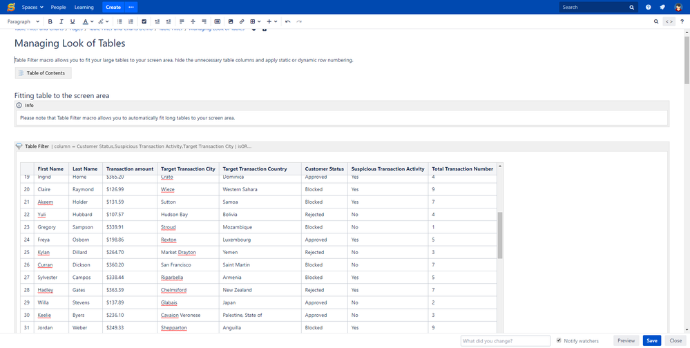

Andrey Khaneev _StiltSoft_
April 25, 2019
I see this when I edit the page:
2019-04-25_15h35_17.pngWhat do you see there? What browser do you use?
CAT
April 25, 2019
I can see exacly the same on demo site (and it's working as I want) / my page confluence page in edition mode (not working the same). I use google chrome.
April 25, 2019
Please, check the version of Table Filter and Charts app in Confluence Administration and update it if possible.

Klara Sommermann
November 13, 2020
Hey @Andrey Khaneev _StiltSoft_ , thanks for your suggestions!
I also have the problem that header rows are not frozen in edit mode, also in the demo page (https://demo.stiltsoft.com/pages/editpage.action?pageId=23724587) you mentioned – when using Chrome as a browser. It works in Safari, though.
Can you point us Chrome users to a solution for this yet?
November 13, 2020
Hi @Klara Sommermann, do you use Confluence Cloud? Freezing of rows works in the editor only in Confluence Server and Data Center.
