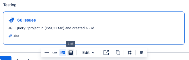

Alas, all I got was a smart card, with an option to make it into a Link, which sure, sombody could click, but we want it to happen... Automagically
So I had to dig DEEPER. And I found this PUT request when I expanded the smart card into a list:
