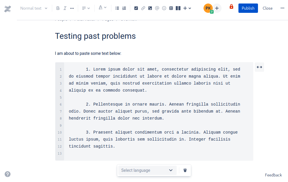

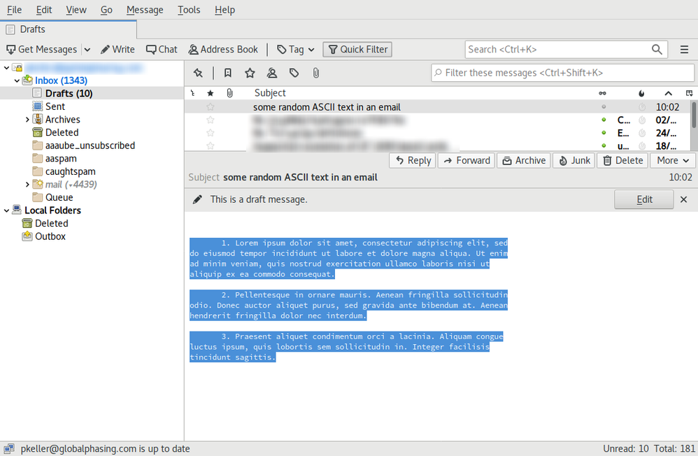

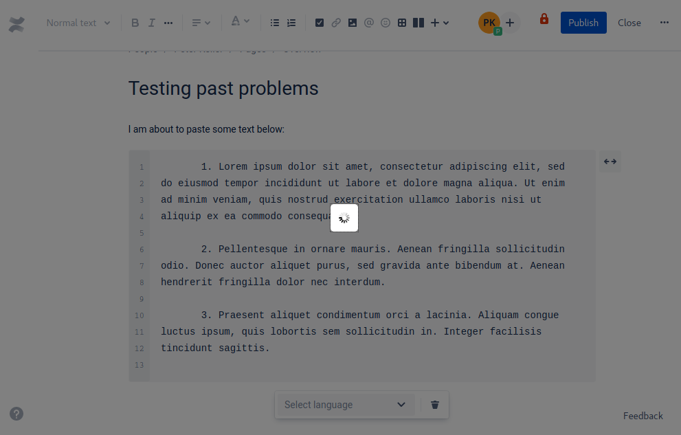

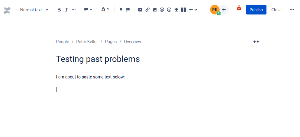

I found that after pasting into LibreOffice Writer and re-wrapping the paragraphs, I get something more sensible, so I managed to get what I needed to do sorted out. However, a "normal" user would find this impossible and just give up. It seems that the Fabric editor attempts to auto-detect the format and it decides whether to paste as code or text without any possibility of the user influencing that choice. The factor that seems to be key here is that the e-mail was formatted as plain text, with LF characters indicating end-of-line rather than paragraph breaks. This happens with plain-text mailers like mutt or Alpine.
I've attached some screenshots which show:
  1. Just before pasting text
  2. Source of copied text (the screenshot shows Thunderbird, but the draft text was created with Alpine)
  3. Just after pasting text
  4. What happens if I click the feedback button to point out the problem :-(
Note that even if I did want to paste something as code, I don't have any control over the starting line number (unlike in the old editor). The hang when I click "Feedback" is just adding insult to injury: the only way out of this is to kill the tab and resume my work from "Drafts". There is so much going wrong here that it is difficult to know where to start. Frankly, I can't conceive of any circumstances where I would use Confluence for a new project, or even suggest to anyone that they look at it.
Confluence-Fabric-before-paste.pngConfluence-Fabric-paste-source.pngConfluence-Fabric-after-paste.pngConfluence-Fabric-feedback-hang.png
I have tried several times to attach some screenshots, but even this instance of the editor is so awful that I haven't managed to do it successfully without losing this text - sorry.
Note that even if I did want to paste something as code, I don't have any control over the starting line number (unlike in the old editor). The fact that the browser hangs when I click "Feedback" is just adding insult to injury: the only way out of this is to kill the tab and resume my work from "Drafts". There is so much going wrong here that it is difficult to know where to start. Frankly, I can't conceive of any circumstances where I would use Confluence for a new project, or even suggest to anyone that they look at it.
