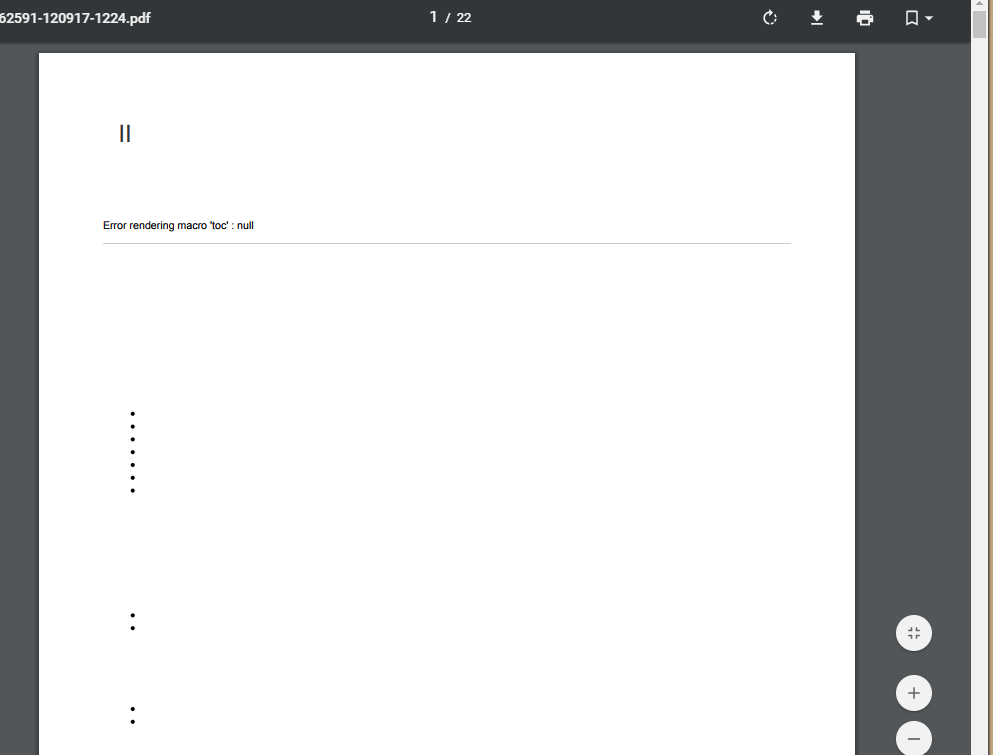

ando
September 12, 2017
Thank you very much for your reply.
This time, I used the "Export to PDF" function of Confluence, but the pdf is still broken. (This time I can see "Error rendering macro 'toc' : null" error on the pdf.)
*IE,Chrome, Chrome-incognito, the result is the same.
By the way, Ctrl+P with Chrome worked fine in July for the same Confluence page.

Yuki Okamoto
September 25, 2017
I'm support engineer in Atlassian and the original problem has already been solved in the support ticket.
The root cause was that the appropriate font file hadn't been installed in the cloud instance. (cf. https://ja.confluence.atlassian.com/confkb/how-to-export-pdf-from-confluence-cloud-in-another-language-779166013.html)
Installing the font file solved the macro break.
