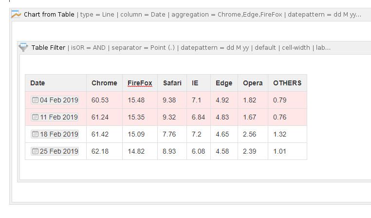

  Thanks for posting this question. To build on @Gasalho Antero's answer, here are the steps to complete your request:
1: Wrap your table in the Chart From Table macro and Table Filter Macro.
Goal: Only expose the last 2 lines of information in the chart.

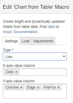

2: Edit your chart. Date = X, Web Browsers = Y

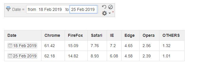

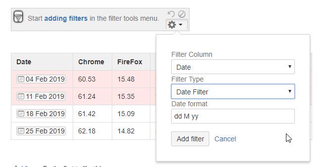

3: Add a filter onto your page for the date range
4: Insert a date range
3.jpgYour chart will then adjust as you change the date ranges.
Hope this helps!

Andrey Khaneev _StiltSoft_
February 4, 2019
Hi @Gasalho Antero,
You can use combination of Table Filter macro and Chart from Table macro to accomplish this. You can watch this video as an example.
