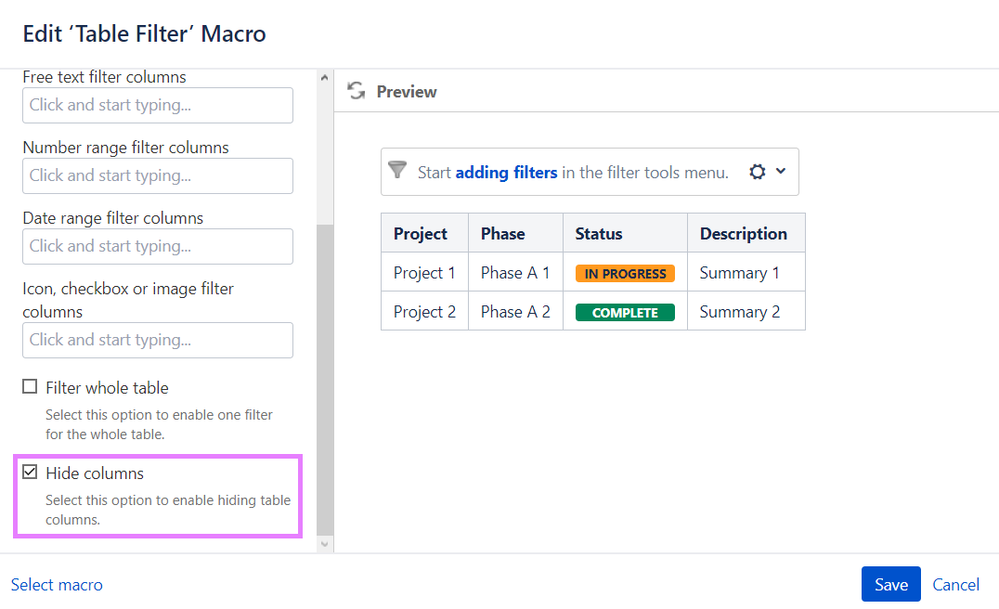

I have created a table using a TableView but there is one column that I use purely for connection with other tables and would like it entirely hidden from the user. Is this possible?

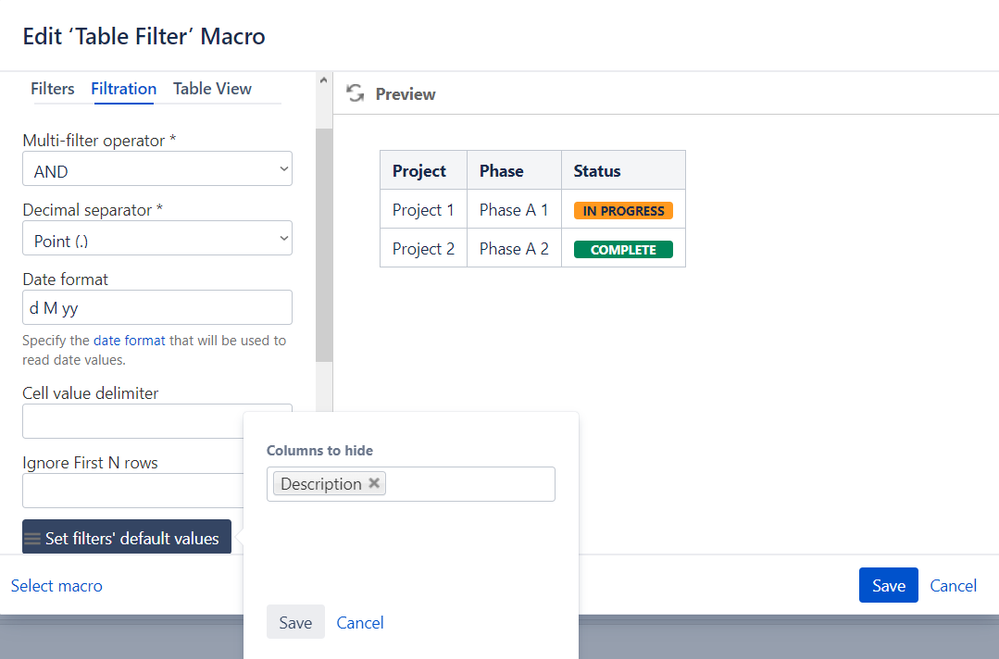

Hi @Michael Confessore ,
You may try to use the Table Filter and Charts for Confluence app that works with ConfiForms TableView macro perfectly well.
Wrap your TableView macro in the Table Filter macro and choose the column that you want to hide:
Hope this helps.
Michael Confessore
December 2, 2020
That worked! Thanks!
