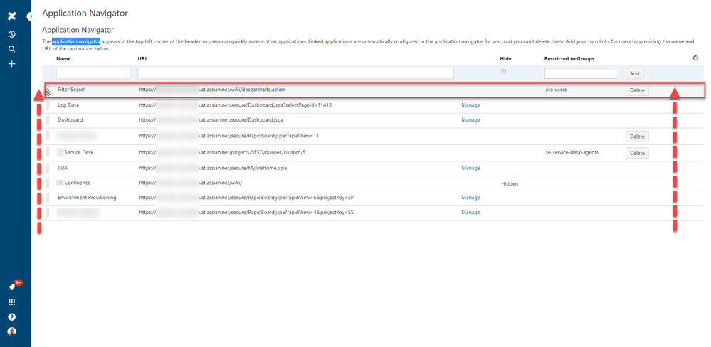

I couldn't find it anywhere, but it is a very useful search, but here is a nice hack that will be with you forever.
Create a shortcut on the Switch to... icon (icon with 9 squares).
  1. At the bottom click on Manage List.
  2. In the Application Navigator give it a Name, paste in the URL (https://mycompany.atlassian.net/wiki/dosearchsite.action), restrict it to a group or not (I gave it (jira-users) and click Add.
  3. Now press the Switch to icon and it should appear on your list.

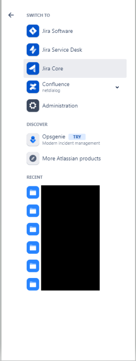

Thank you for the work around. I wanted to incorporate it, since it seems pretty useful. But for some reason I don't get the 'More' options there. Do you know how that could be? I am system administrator.

Were you able to click the Manage List link to add the URL? The word 'Manage Link' is right at the bottom of the Application Navigator Bar (which is the bar on the very left of the Confluence page accessible by pressing the icon with 9 squares). Here are the steps:
  1. Click Switch to icon, which opens the Application Navigator.
  2. At the bottom of the Application Navigator click on Manage List.
  3. A window opens - Give it a Name (e.g. Filter Search), Paste in the URL (https://mycompany.atlassian.net/wiki/dosearchsite.action), restrict it to a group or not (I gave it (jira-users) and click Add.
  4. Now press the Switch to icon and it should appear on your list.
  5. It might be that it appears right at the bottom, in which case re-visit the Manage List and move (drag with mouse) the Filter Search to the top of the Application Navigator list.
-Mike
Dara
January 22, 2020
Hi @Mike Bowen, as you can see in the screenshot, my issue is that the 'Manage List' option doesn't seem to be visible (or present at all really).. Which seems weird. My company uses a regular version of Confluence Cloud.
Mike Bowen
January 23, 2020
Hi @Dara
I checked a colleague of mines who is not an administrator in Confluence/Jira Service Desk and they don't have the manage list either.
So it is a permissions thing. I am a Site Administrator or someone who can determine user access, and update billing details.
