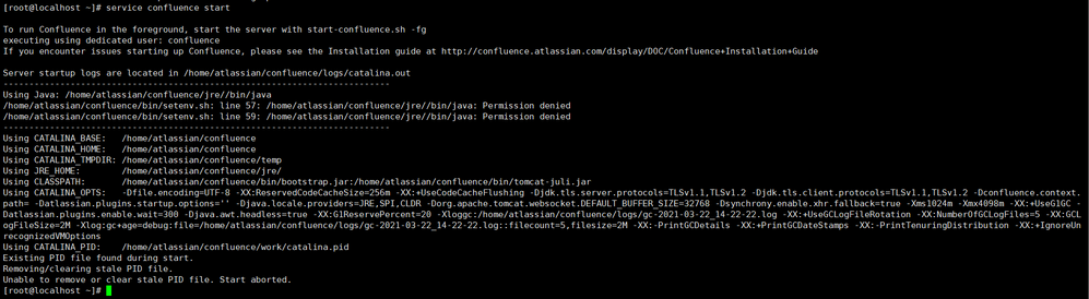

My installation directory, accessories, database, etc. are all in the "home" directory.My everything is installed in a virtual machine. I copy a new one from the original virtual machine. At this time, I backup the "home" directory of the original virtual machine and replace the "home" directory of the new virtual machine. At this time,it is found that confluence and jira services in the new virtual machine cannot be started
So,I am very confused about how to achieve what you said "This backup could be copied to any replacement server in one go and simply started"

The error message you are getting is not about the file and data copy though, it's almost certainly to do with file ownership, which we are discussing over at https://community.atlassian.com/t5/Confluence-questions/Confluence-server-start-error/qaq-p/1643917

In the first picture of the problem, the "confluence" and "jira" directories in the “home”directory are my user files . If I replace the whole “home”, Even if the file name is the same, the user will be replaced, resulting in the loss of file ownership.
So according to the picture, In terms of my current installation directory in the picture,I need to back up all the files in the path "/home/atlassian/", right?
