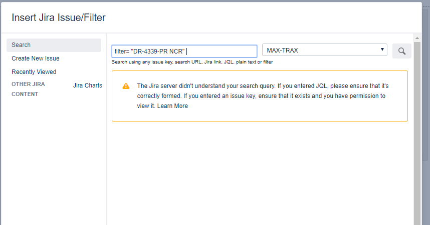

When setting up the JIRA Issue macro I receive the following error message for JQL or for a filter:
"The Jira server didn't understand your search query. If you entered JQL, please ensure that it's correctly formed. If you entered an issue key, ensure that it exists and you have permission to view it.".
1) I can see the data if I run the query within JIRA
2) I can use the same JQL or filter within a Jira chart in the same macro and the data renders correctly without the error
3) I have tried the workarounds in this ticket: https://jira.atlassian.com/browse/CONFCLOUD-65911
Any thoughts on next steps for troubleshooting this?

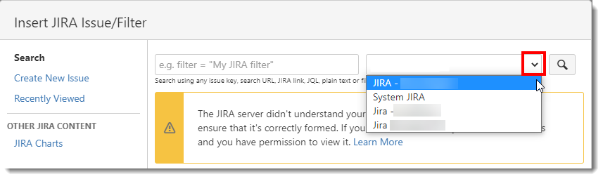

We we're getting the same issue and have a workaround (if you have more than one tenant linked):
EDIT: We're on Jira Cloud so result may vary

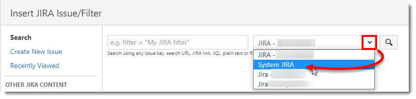

  1. In the dropdown to the right, choose another tenant (any will suffice, in this instance, System Jira is the intended target):
  2. Go back to the dropdown to the right and re-select the targeted tenant (in this instance, System Jira is the intended target):

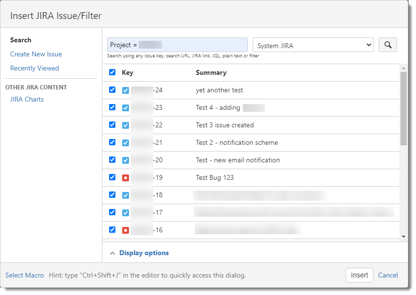

  3. Re-enter your search and the results should appear:

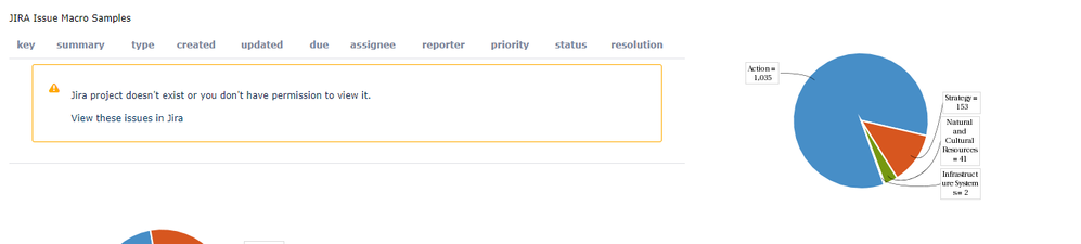

Confluence 6.13.8
I have attached two error messages - one in preview and one in the fully rendered page.  The pie chart to the right of the error message is using the same filter.  The JQL underneath the filter is: "labels = DR-4339-PR-NCR"

Hey @Larry , it would be great if you can share a screenshot, your JQL and the Confluence version you're in so that we can assess your question a bit better.
