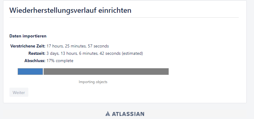

trying to create a docker-instance of confluence and restoring the backup yields the following:
Currently stalling. the backup.zip file was about 400 MB in size and has been put into the restore directory. Is there a faster possibility to recreate our realtively small instance?

Could you let me know if you're using the XML backup as a method to perform the upgrade that was recommended by my colleague in order to eliminate the bug?
If so, please note that our Upgrading Confluence documentation:
XML backups should not be used to upgrade Confluence.
Please be sure to follow the above documentation for the recommended upgrade procedure.
