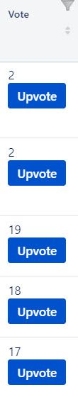

  • Voting field count sorted in Descending order but again it follows the above logic of sorting thus giving incorrect results which means 2>19  -

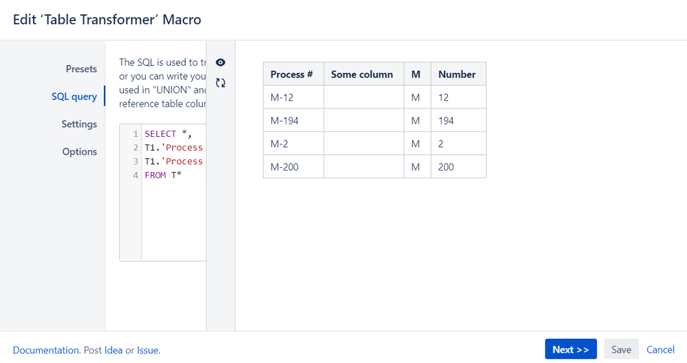

We can suggest a workaround for the first case: wrap your ConfiForm macro into the Table Transformer macro and then into the Table Filter macro.
Use the following SQL query for the Table Transformer:
SELECT *,
T1.'Process #'->split("-")->0 AS 'M',
T1.'Process #'->split("-")->1 AS 'Number'
FROM T*
It will split your "M-XX" into two columns (M and some number), so you'll be able to sort them properly later:

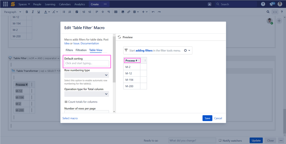

When I check the sorting using a manually created table and the Table Filter macro, here is my result:

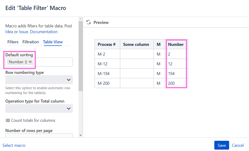

After the Table Transformer macro the result is different:

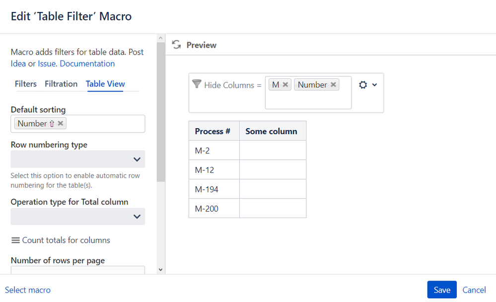

Katerina Kovriga _Stiltsoft_
June 3, 2021
You'll be able to hide the unwanted columns:
This example is for the classic panel view but you can also hide columns via the header filters view as well.
Besides sometimes Table Transformer may help even without any splitting - for example, for my manually created table sorting works right if I simply wrap my table into the Transformer.

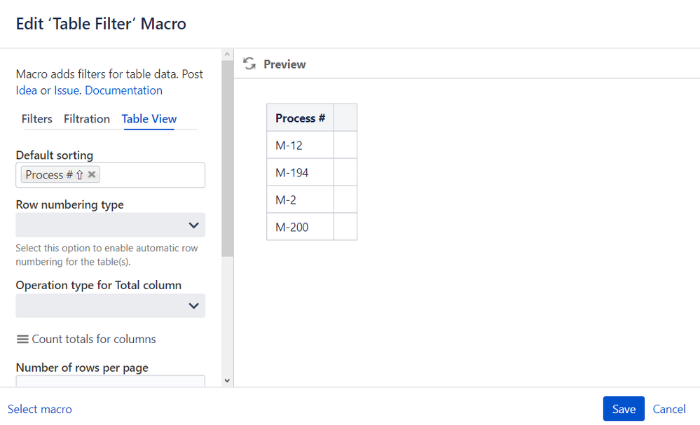

June 4, 2021

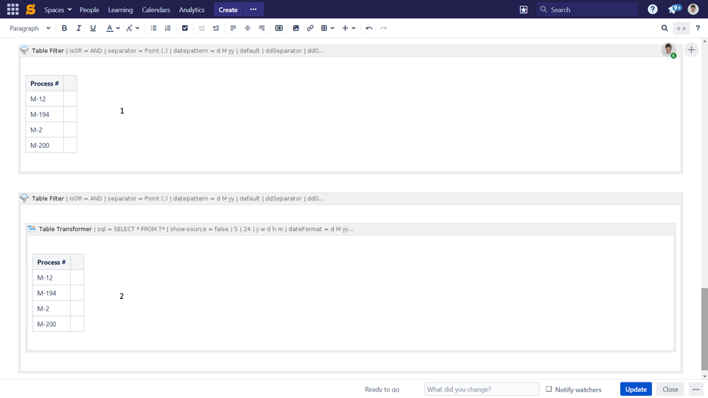

Here is how the default Confluence sorting into headers works for me:
The first variant is wrong - it's a table wrapped into the Table Filter macro (without it's own sorting).
The second variant seems to be right - it's a table wrapped into the Table Transformer macro and then into the Table Filter macro.
I don't use any specific settings for the Table Transformer - just insert the macro and put a table inside its body (I don't change the default SQL - it remains "SELECT * FROM T*").
And I don't use any sorting inside the Table Filter macro - just click the standard arrows in the table headers and it seems to be working.
