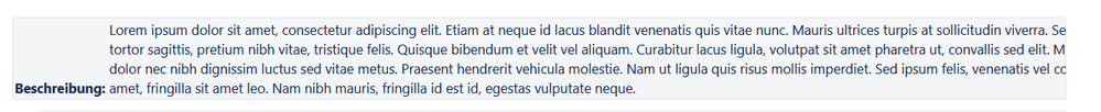

I want to use the Assets object macro to pull a multiline block of text out of our database. Its a single attribute and im using the Display as "Single Insline Object".
But before the text the word describtion (in German: "Beschreibung") is placed, which ruines the formatting of the text. (look examble below)
Examble:

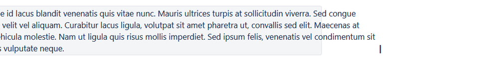

It may not be fully clear from the picture but i need to scroll to see the right side of the text.Screenshot 2024-07-18 143706.png
As u can see the text overrides the border.
If u have any idea where this problemm is coming from or how to fix it.

Before I begin, please specify your Confluence Data Center and Assets (Insight) app versions. Display of long text attributes varies by version, so this info ensures accurate support.
When an attribute appears as a Single Inline Object, Confluence shows the label and value side by side within a fixed-width container. If the text is too long, it won't wrap but will instead overflow, giving you the option to scroll horizontally, just like in your screenshots.
A few things I would try:
  • Wrap the macro within an Expand or Panel macro with fixed width to ensure proper wrapping, which may not occur with raw inline display.
  • Checking the raw value directly in Assets for line breaks or hidden HTML.
  • Check if the attribute is defined as Text or Textarea in Assets schema. Text attributes render inline without wrapping; Textarea behaves differently.
  • Instead for a Single Inline Object, use the standard object table display limited to one attribute column and hide the header row. This uses a full-width table cell that wraps normally instead of a narrow inline container.
  • If none of that helps, this seems to be a CSS limitation of inline display for long text values, not a setup issue, and worth a support ticket with your version details.
Could you please share the attribute type (Text vs Textarea) and let me know if you're still experiencing this issue on your side? Thank you!
