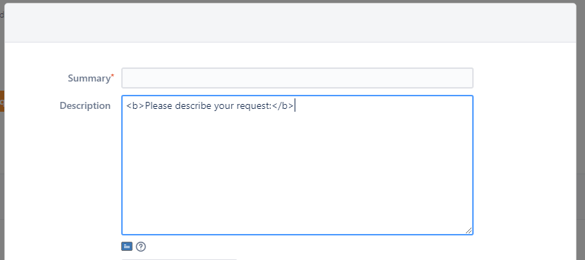

In my Issue Collector, I want to format the pre-filled Description field text as BOLD. When I use Javascript .bold() it produces an interesting result!
$(document).ready(function() {
// === I SET THE VALUE OF MY VARIABLE AND CALL THE BOLD METHOD
var describe = ('Please describe your request:').bold()
window.ATL_JQ_PAGE_PROPS = $.extend(window.ATL_JQ_PAGE_PROPS, {
'ce68de52' : {
triggerFunction : function(showCollectorDialog) {
$('#feedbackbutton').click(function(e) { e.preventDefault(); showCollectorDialog(); }); } , fieldValues: {
// === I PASS MY VARIABLE INTO THE VALUE OF THE DESCRIPTION FIELD, THE RESULT IS HMTL AS TEXT???
description : `${describe}`
The above code displays as shown in the picture below. How do I format that pre-populated text as bold?? I am stumped!!

Description fields use wiki mark up, not html.
You should use *Please describe your request.*
More about wiki mark up is available at: https://confluence.atlassian.com/doc/confluence-wiki-markup-251003035.html

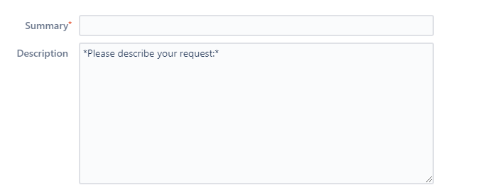

Correct me if I am wrong, but in order to embed an issue collector on a Confluence page, one must use the HTML macro.
When I format the text within the HTML macro with wiki markup (*Please describe your request*) as you have recommended it displays as such within the description field. It is not bolded, it displays text with asterisks. boldText2.png
I would like the user to see BOLD TEXT in the issue collector itself. Not simply text with the asterisks.
