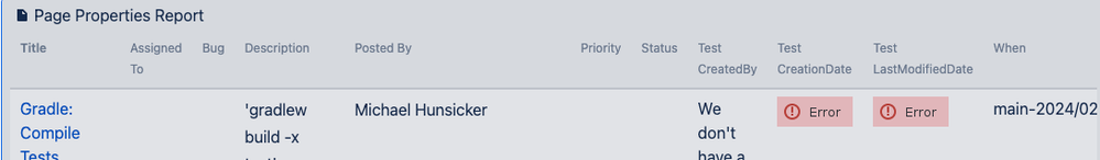

I have Page Properties Report macros set up to display a list of pages. Within these pages, I've integrated custom macros developed with Forge and UI Kit.
A single Standalone page: Macros work fine (first 4 rows)
Errors:
As you saw above, the macros work fine in any standalone page, but displays error in the Page Properties  Report (see the image below).
There are 3 things happening in the image above.
1.The first error occurred in the 'Test CreatedBy' column, where the 'we don't have a way to export this macro' error was encountered due to the usage of UI Kit 2. Interestingly, the macro works fine and displays the value 'Hello World (UI Kit 2)' on standalone pages.
2.The second issue arises with errors in the TestCreationDate and TestLastModifiedDate columns, both utilizing Forge macros with UI Kit. While these macros function correctly on standalone pages, they fail to display properly within the Page Properties Report.

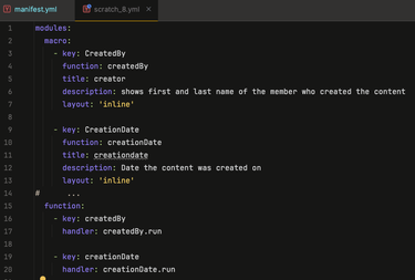

I've developed three separate components in three different JSX files and specified them in the manifest.yml file. To insert these macros into pages, I use a forward slash followed by the macro name or title. This allows the page to display the values generated by these macros.
3.  This is an interesting discovery: none of the approaches worked within the Page Properties Report Macro except for this specific method. By copying the code from creationDate.jsx and pasting it into the index.jsx file, the macro successfully displays values both on standalone pages and within the Page Properties Report Macro..

From the screenshot of the manifest you provided, I noticed you're using the old UI Kit (1) `function` param - updating it to the manifest structure of UI Kit (2) may help - ignore if you've migrated already. See the snippet below or the docs.
I've just tested with a new UI Kit (2) app and I'm able to render the macro successfully in the page properties report. However, I did use a very simple setup - what version of `@forge/react` are you using?
This is what I see with a UI Kit (2) app:

Hm this should work, with multiple macro modules your manifest should follow something like this:
modules:
macro:
- key: macro-key
resource: main
render: native
resolver:
function: resolver
title: My macro
- key: second-macro-key
resource: second-resource
render: native
resolver:
function: resolver
title: My second macro
function:
- key: resolver
handler: index.handler
resources:
- key: main
path: src/first-macro/frontend/index.jsx
- key: second-resource
path: src/second-macro/frontend/index.jsx
app:
id: "<your app id>"
If updating the app to the latest version of `@forge/react` doesn't work, can you send the contents of index.jsx and creationDate.jsx?
