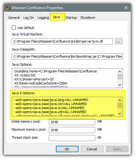

Jannik Meibom
October 27, 2023
Hi,
We had the same experience after upgrading Confluence from 7.13.7 to 8.5.2.
We started getting the Font Health Check failure and the solution was found here:
Fonts health check failed in Confluence 8 with Java 17
We had to configure the Windows Service with this command:
tomcat9w //ES//<SERVICENAME>
as described in this article:
Configuring System Properties
We added all the mentioned entries in the Java 9 Options section under the Java tab:
Hope it helps...
