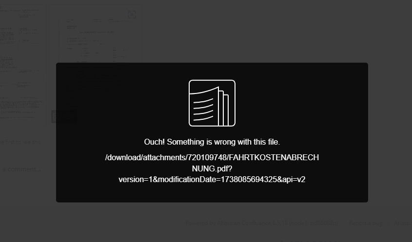

When I attach pdf file or some other in confluence data center 8.5.18 and when I want to see preview of it Im not able to see it

Yes it is only the Preview that doesnt work.
we have update our confluence 8.5.14 to 8.5.18 and had to do this two : The JDBC driver for MS SQL Server has been upgraded from version 7.4 to 12.6. If you are using SQL Server via JDBC and your database isn't configured for SSL connections, you must explicitly disable encryption in Confluence's connection URL string. With the updated driver, encryption is enabled by default. To disable it, append ;encrypt=false to the existing connection string. We recommend making this update before upgrading to avoid any downtime.
and fom them preview is not working
tried everithing from cache clean to plughins reenable to restart confluence
and nothing is working
before update preveiw was working

Thank you for your response.
I Have fixed the problem by upgrading Linchpin Events plug-in
Atlassian Support suggested.
You're welcome. Thanks for sharing your updates. This will help community for those who also have the linchpin app and facing this issue.
Same here, we had to update the linchpin intranet suite to solve this problem. Thx Marko for posting your solution.
