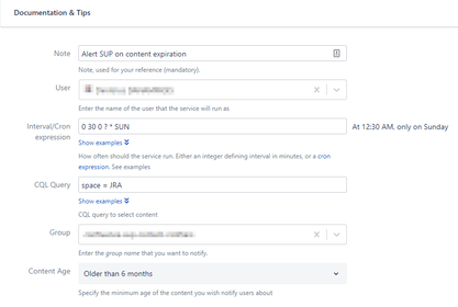

I am trying to create a Job in Scriptrunner using one the built-in scripts: Old Content Notifier
An error appears when I am running the job manually:
Error: javax.mail.Provider: Provider com.sun.mail.imap.IMAPProvider not found
java.util.ServiceConfigurationError: javax.mail.Provider: Provider com.sun.mail.imap.IMAPProvider not found at com.atlassian.confluence.jmx.JmxSMTPMailServer.doSendWithMessageIdSupport(JmxSMTPMailServer.java:97) at com.atlassian.confluence.jmx.JmxSMTPMailServer.send(JmxSMTPMailServer.java:79) at com.atlassian.mail.server.SMTPMailServer$send$0.call(Unknown Source) at com.onresolve.scriptrunner.canned.confluence.jobs.TimedArchivalNotification.sendEmail(TimedArchivalNotification.groovy:227) at com.onresolve.scriptrunner.canned.confluence.jobs.TimedArchivalNotification$_execute_closure1.doCall(TimedArchivalNotification.groovy:161) at com.onresolve.scriptrunner.canned.confluence.jobs.TimedArchivalNotification$_execute_closure1.doCall(TimedArchivalNotification.groovy) at com.onresolve.scriptrunner.jobs.ConfluenceIdentitySwitchingService$_switchIndentityAndExecute_closure1.doCall(ConfluenceIdentitySwitchingService.groovy:30) at com.onresolve.scriptrunner.jobs.ConfluenceIdentitySwitchingService$_switchIndentityAndExecute_closure1.doCall(ConfluenceIdentitySwitchingService.groovy) at com.atlassian.confluence.user.AuthenticatedUserImpersonator$2.call(AuthenticatedUserImpersonator.java:118) at com.atlassian.confluence.user.AuthenticatedUserImpersonator$1.call(AuthenticatedUserImpersonator.java:101) at com.atlassian.confluence.user.AuthenticatedUserImpersonator.asUser(AuthenticatedUserImpersonator.java:82) at com.atlassian.confluence.user.AuthenticatedUserImpersonator$asUser.call(Unknown Source) at com.onresolve.scriptrunner.jobs.ConfluenceIdentitySwitchingService.switchIndentityAndExecute(ConfluenceIdentitySwitchingService.groovy:29) at com.onresolve.scriptrunner.jobs.IdentitySwitchingService$switchIndentityAndExecute.call(Unknown Source) at com.onresolve.scriptrunner.canned.confluence.jobs.TimedArchivalNotification.execute(TimedArchivalNotification.groovy:165) at com.onresolve.scriptrunner.canned.confluence.jobs.TimedArchivalNotification.execute(TimedArchivalNotification.groovy)
The configuration of the mail server is fine and there is no issue with the sending confluence sending mails.  We are running on Confluence v7.2 and Scriptrunner v6.7
Any ideas on how to fix that?
Joshua Yamdogo @ Adaptavist
September 15, 2020
Hi Dimitrios,
We are aware of the exception being thrown whenever the Old Content Notifier job is ran manually. We have created an issue in our backlog here: https://productsupport.adaptavist.com/browse/SRCONF-1413
If you would like to go ahead and watch that issue, you'll receive a notification whenever the bug has been resolved.
Apologies for the inconvenience,
Josh
