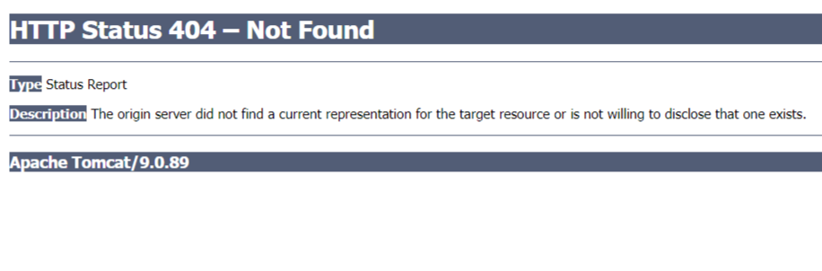

Sagar Patil
July 26, 2024
Hi @Charlie Misonne ,
Now I am getting 404 error and it's window machine, Can you please provide solution ?
Description The origin server did not find a current representation for the target resource or is not willing to disclose that one exists.

Charlie Misonne
July 26, 2024
Hi @Sagar Patil
So you're getting a 404 now but did you change anything? Do you have other errors in the logs?
Did you make sure the port is not in use yet?
