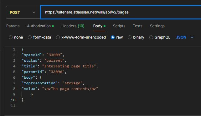

Aaron Pavez _ServiceRocket_
January 3, 2025
With postman you dont need to user curl.
2025-01-03 17_10_37-https___sitehere.atlassian.net_wiki_api_v2_pages - Jira_Confluence.jpg
add the URL
in authorization
- Username: use your email
Password: your token
the body is the one I've shared earlier. select raw and JSON at the end.
That should do it.
regards

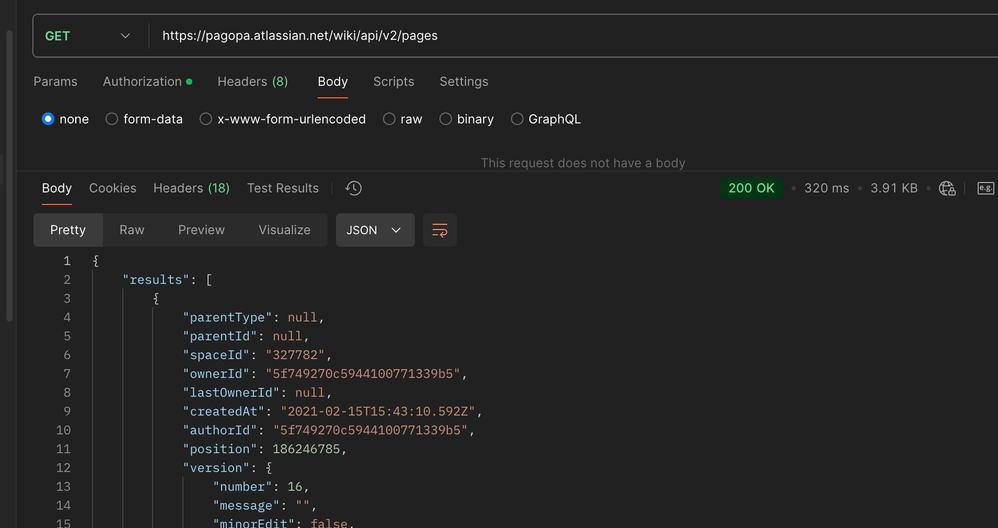

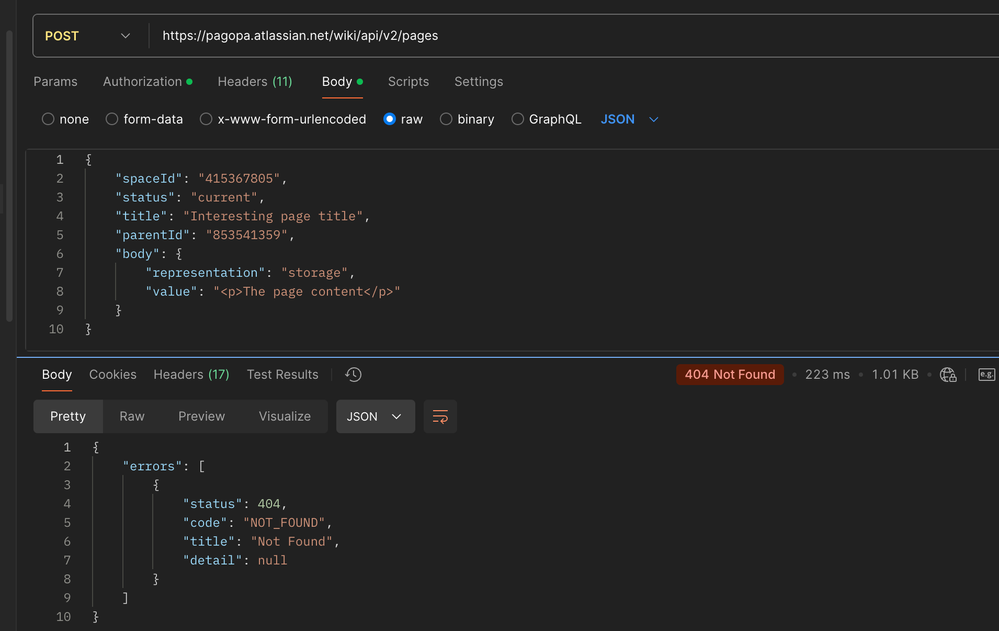

Cristiano Sticca
January 3, 2025
Here you have:
1) the API that works (Get Pages)
2) the API that doesn't work (Create Page)Screenshot 2025-01-03 alle 21.16.24.png
Same url, same user, same API token ...
