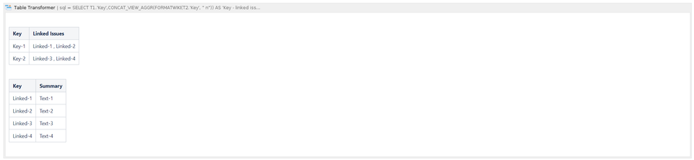

Hi @Aleks Irinics ,
The Table Transformer macro considers each table as a mini database, so your 'headers' should be in a header row (to call them out in the SQL query) and not in the column as it is shown on the first screenshot.
So, you may replicate the example from our documentation mentioned above with a slight change just to put summary in the same cell with Linked Issues keys:
not
CONCAT_VIEW_AGGR(FORMATWIKI(T2.'Key', " \n")) AS 'Key - linked issues', CONCAT_VIEW_AGGR(FORMATWIKI(T2.'Summary', " \n")) AS 'Summary - linked issues',
 but
CONCAT_VIEW_AGGR(FORMATWIKI(T2.'Key', " | ", 'Summary', " \n")) AS 'Key and Summary - linked issues',
Please check the simplified example below:

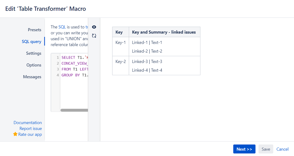

SELECT T1.'Key',
FROM T1 LEFT JOIN T2 ON T1.'Linked Issues'->split(" , ")->indexOf(T2.'Key'::string) > -1
GROUP BY T1.'Key'
Hope it helps.
