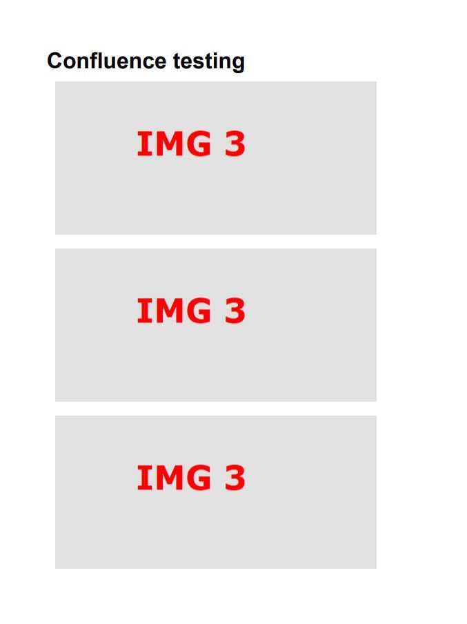

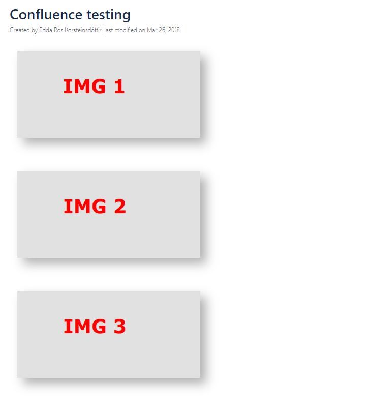

I have a problem after upgrading to Confluence  from 6.4.3 with exporting Spaces og pages with attactedment (PNG & JPG images)to PDF. Images will come as random order in PDF file, or 1 out of 3 images are as 1 images for those different three.
This is working 100% using export to Word !
Has anyone been in this situation?

This test case has .PNG images, we allso tested in .JPG with the same results.
To reproduce: Save different images (PNG or JPG) on Confluence page. Select export to PDF button. Results should be random image order will appear in PDF output.
Will be correct in export to Word.

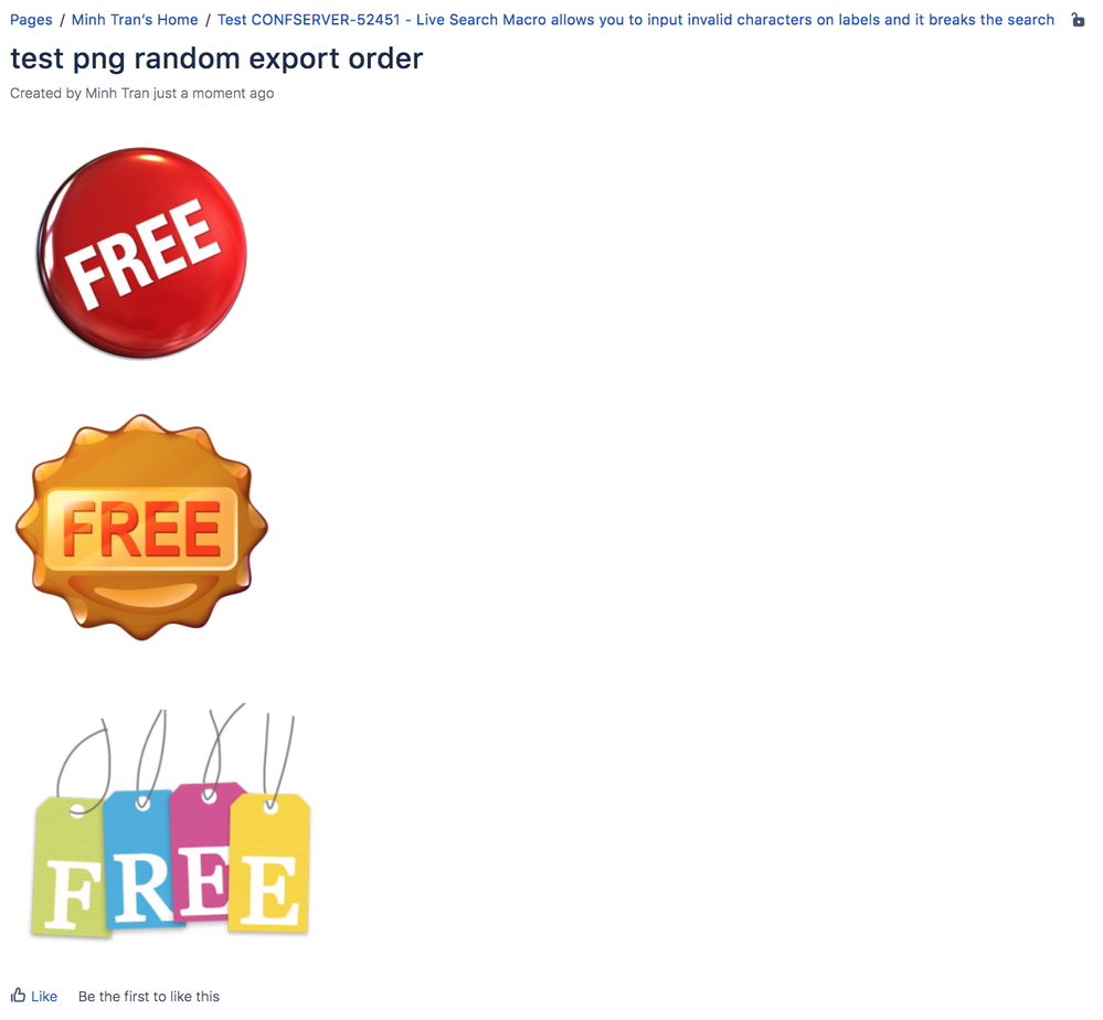

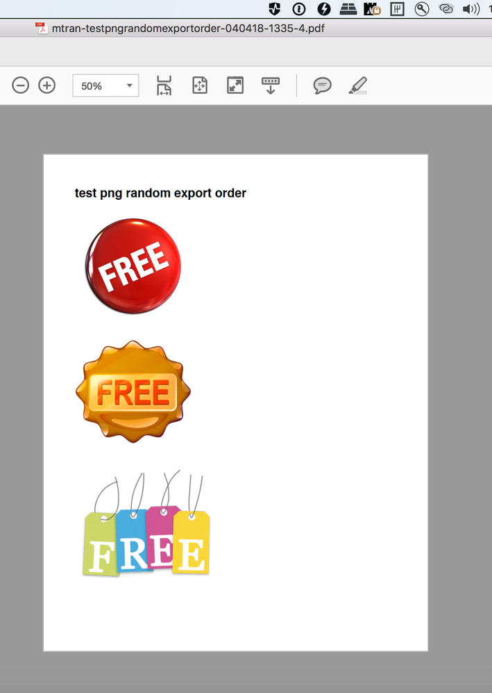

I am testing 2 cases:
First one is all 3 png files test png random export order - Minh Tran - Bulldog 2018-04-04 23-37-09.png
Here is the corresponding export pdf

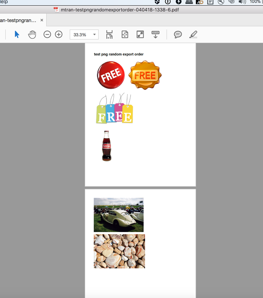

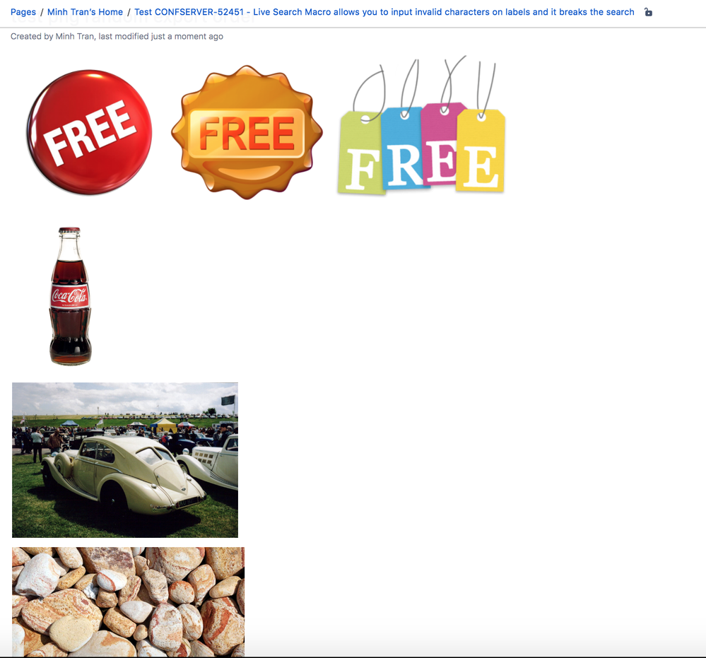

Another case is 3 png on the top and then 3 jpg next to those.
and the export pdf of that page:
Those look good to me in the Confluence 6.8.0+
