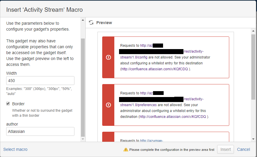

Hi all,
I am getting the following error while adding the Activity Stream in Confluence. Please suggest a solution for the problem. I have also white listed the url's and checked but no use.
Error Message:
Requests to http://az*******************************/rest/activity-stream/1.0/preferences are not allowed. See your administrator about configuring a whitelist entry for this destination (http://confluence.atlassian.com/x/KQfCDQ ).

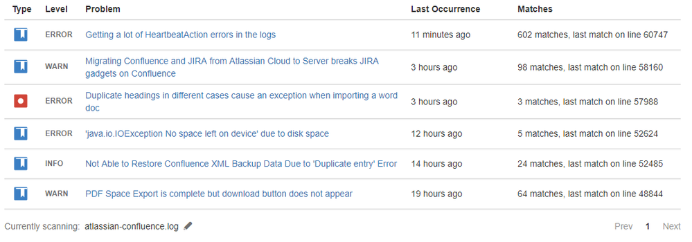

mail2sebastianpeter March 22, 2018
We are using the confluence version 6.2.4
The url that i blacked out is an azure server location.
 If you think anything to be resolved in this log please tell as i am new to confluence.
Shannon S
March 23, 2018
Sebastian,
The messages in the screenshot don't pertain to the issue you're having currently.
My recommendation is to check the log file itself from your server. You can tail it while you trigger the error from earlier, and it should give you further information about the problem.
