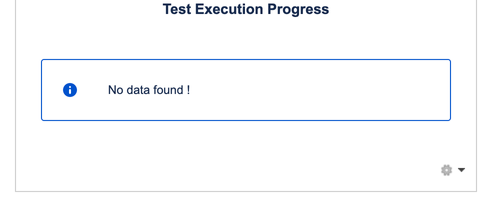

I am trying to add a donut graph of our Automated Test Suite to a confluence page via the "Test Execution Progress" Macro. However, when I add this in, the macro only displays
"No data found !"
There is another macro called "Test execution" that is a bar graph and it displays the information correctly.
These are both connected to Zephyr test cycle executions, and both of these macros work in our JIRA instance. But when I add the Macro to confluence, i just get the error mentioned above.
Is this a known issue or is there a fix? Anyone else see this? Thanks!
Here's a screenshot of the Macro after saving the changes on the confluence page:

Leya Abraham
July 24, 2020
Hi,
In the Confluence page source the  "Test Execution Progress" Macro will be added as something like below.
<p>
<ac:structured-macro ac:macro-id=macro_id ac:name="gadget" ac:schema-version="1">
<ac:parameter ac:name="preferences">folders=null&amp;cycles=1234&amp;cycleExecutionStatusName=Test%20Execution%20Progress&amp;projectId=5678&amp;version=000&amp;chartType=pie&amp;showProjectName=true&amp;showVersionName=true&amp;isConfigured=true&amp;refresh=false</ac:parameter>
<ac:parameter ac:name="url">jira_url</ac:parameter>
</ac:structured-macro>
</p>
The issue is basically because Folder value is given as empty and it coming as null in macro folders=null. So as a workaround, removing this worked for me. Like below
<p>
<ac:parameter ac:name="preferences">cycles=1234&amp;cycleExecutionStatusName=Test%20Execution%20Progress&amp;projectId=5678&amp;version=000&amp;chartType=pie&amp;showProjectName=true&amp;showVersionName=true&amp;isConfigured=true&amp;refresh=false</ac:parameter>
</p>
