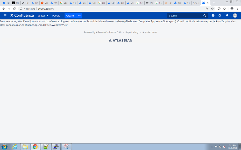

Hi Team
I am getting the below error when I restarted the confluence Server.
Error rendering WebPanel (com.atlassian.confluence.plugins.confluence-dashboard:dashboard-server-side-soy/DashboardTemplates.App.serverSideLayout): Could not find custom mapper jackson2soy for class class com.atlassian.confluence.api.model.web.WebItemView
How to resolve this ?

Hi @Elifcan Cakmak
I tried with both the resolutions. Both didn't worked for me
1.With the First resolution
I followed the first procedure i.e I added the -Datlassian.plugins.enable.wait=300
argument to Java properties in the setenv.sh file. Then I restarted the server.But No luck
2.With the Second resolution

2019-10-07 12:20:13,164 WARN [http-nio-8090-exec-2] [plugin.web.model.ResourceTemplateWebPanel] writeHtml Error rendering WebPanel (com.atlassian.confluence.plugins.confluence-dashboard:dashboard-server-side-soy/DashboardTemplates.App.serverSideLayout): Could not find custom mapper jackson2soy for class class com.atlassian.confluence.api.model.web.WebItemView
-- referer: http://<baseUrl>/index.action | url: / | traceId: a3bba50137de32cc | userName: sushma | action: dashboard
com.atlassian.plugin.web.renderer.RendererException: Could not find custom mapper jackson2soy for class class com.atlassian.confluence.api.model.web.WebItemView
