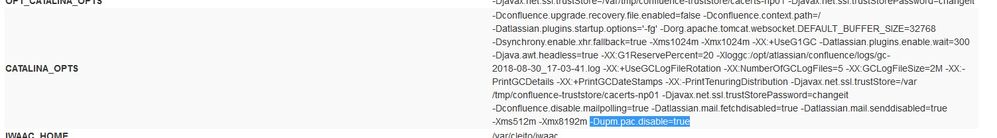

and as suggested the following is set: -Dupm.pac.disable=true and it can be found in Confluence > Systeminfo settings
