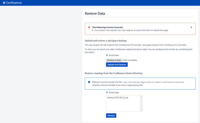

Before, we have installed PostgreSQL for use it with Confluence (6.14).
We have got error, when we try to install Confluence with restoring from backup (we have installed Confluence on embedded database H2).
We try restore data from backup, but can't continue installation: we have got error - ''Your session has expired" – look attached screenshot.

My best guess is that the H2 database is failing on the import.  There are reasons Atlassian tell us to use it only for test, and this type of failure is one of them!
Could you install a supported database and re-try the import?

It was new installation. Confluence was successfully connected to Postgres, but when we try restored data we got this error
