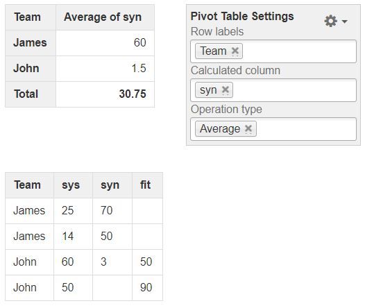

Here is the tables I am using. I would like the average for John to show 3 instead of 1.5, because the bottom cell for John is blank, not 0. But I think that confluence considers blank = 0. Is there any way to change that?

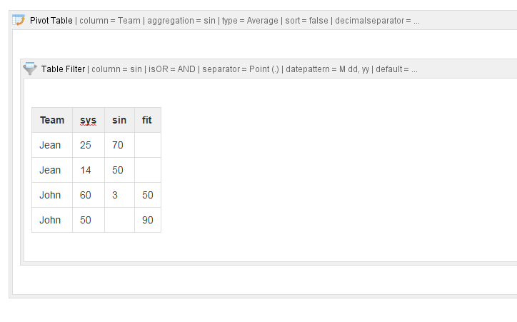

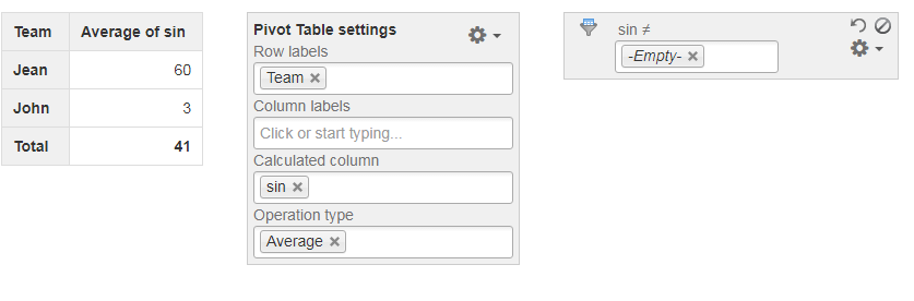

Did you try the following?

Andrey Khaneev _StiltSoft_
September 15, 2017
Just click the '=' sign next to 'sin' label to make it not equal and save changes in filter (option under cog wheel).
