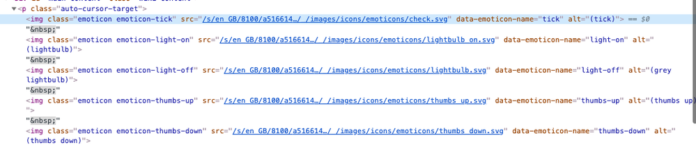

Normann P. Nielsen (Netic)
May 1, 2019
I have upgraded from 6.15.1 to 6.15.3 - no Emoticon icons.
They are in the filesystem:
root@atlassian01:/pack/confluence/confluence# find . -name lightbulb.svg
./images/icons/emoticons/lightbulb.svg
root@atlassian01:/pack/confluence/confluence# find . -name check.svg
./images/icons/emoticons/check.svg
And its not http/https:
