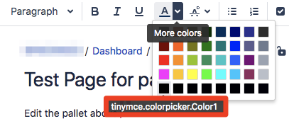

Something to keep in mind is that you must select a color name listed within tinymce.colorpicker or your colors named will not display properly, example here for an incorrect name;

When I tested and wrote the solution above I was able to create and edit pages (thus the screenshot above). I would be interested to know what was modified and how. From that, I would be able to retest and see if there is an issue.
Please let us know the steps you took to edit the color pallet and what was edited exactly within the files.
