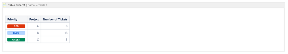

Step 1. Collect all your your big tables from different pages on the one particular page with the help of the Table Excerpt and Table Excerpt Include macros (we mean "reuse" your tables).
1.pngStep 2. Join your tables with the help of the Table Transformer macro (use the default Merge preset).

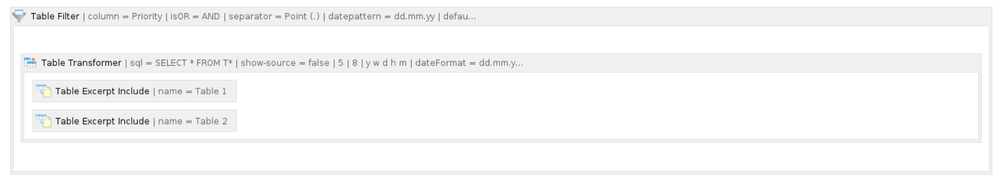

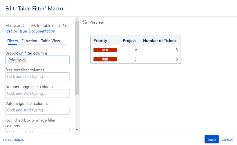

3.pngStep 3. Filter your combined table by the required status.
4.pngIf your hosting is Cloud, you'll need the Table Toolbox macro to nest several macros.
Our app allows you to use different macro combinations, so you'll be able to work with your tables in a neat and flexible way.
