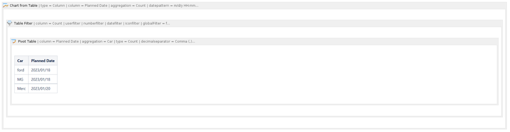

We can suggest trying our app – Table Filter and Charts for Confluence. Create the following macro sequence (directly if your hosting is Data Center/Server or via the Table Toolbox macro if you are on Cloud):

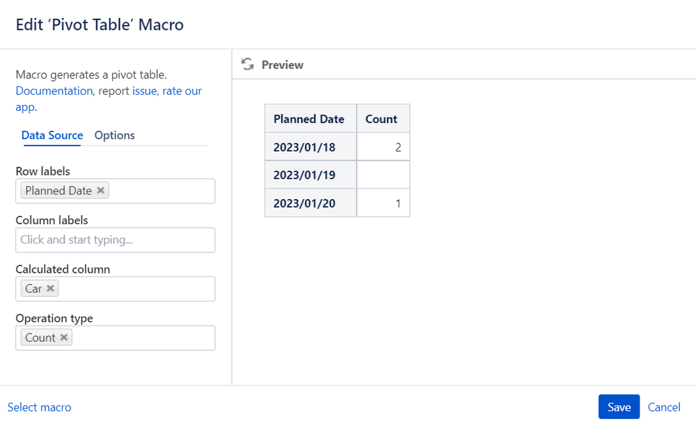

Use the Pivot Table macro to group your entries by dates:

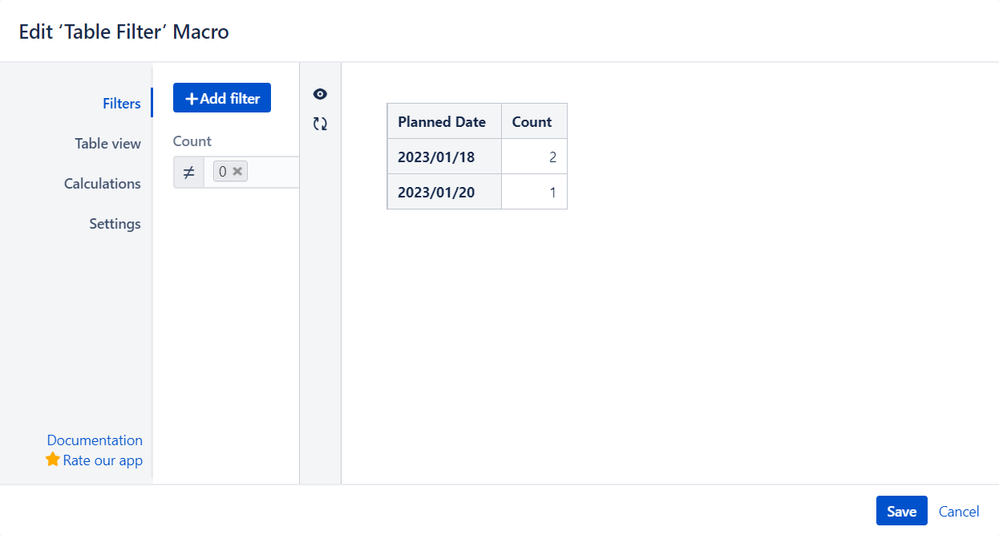

If necessary, filter the empty dates out with the help of the Table Filter macro:

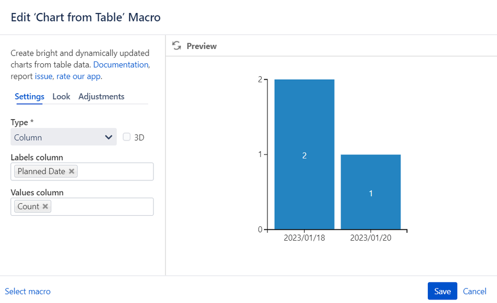

Create the required chart using the Chart from Table macro:
