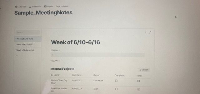

Coming to Confluence from Coda. Coda's Detail View table display is very handy and I am trying to recreate it within Confluence. Not having much luck. Does anyone have a suggestion(s) on how to accomplish as similar of a view? Short example screenshot attached.
For those who have not used Coda, the Detail View is essentially a main table within a page that can have store pages of notes/actions over time that are labeled on the side of the table. It is good to tracking meeting minutes, notes, projects, and actions over time.
Thanks in advance.

@Brant Schroeder's answer with the Page Properties macro is the best solution right now.
But, Confluence Databases are also coming, and when it is generally available, it could be even better!

Thanks for the quick reply, Aron. Agreed - Brant's suggestion works for my needs.

The closest thing I can think of would be to add page properties and then add the page properties report onto a main page that pulls all the information in.  https://confluence.atlassian.com/doc/page-properties-macro-184550024.html

This is definitely close and works perfectly for my needs. Thanks Brant!

Indeed, you may use the Page Properties/Page Properties Report macros to collect one-row tables from different pages into one big report on the master page as @Brant Schroeder has mentioned.If you need to collect bigger tables with data, we can suggest using the app that we develop – Table Filter and Charts for Confluence.
Its Table Excerpt/Table Excerpt Include macros work like the standard Page Properties/Page Properties Report macros but allow you to collect multiple-row tables.Later with the help of our other macros you’ll be able to filter, aggregate, and visualize your master report.
