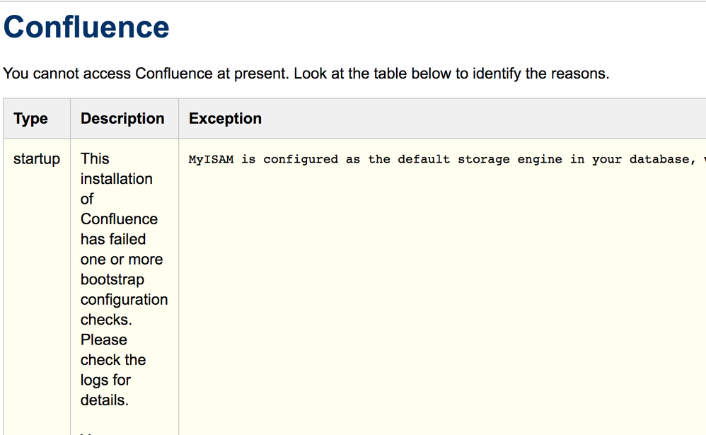

Thomas Zöger
August 31, 2017
No it's not only a warning. after the startup was finished with running, the browser shows the following page:
logfile contains:
..,803 ERROR [localhost-startStop-1] [atlassian.confluence.setup.BootstrapApplicationStartupListener] checkConfigurationOnStartup MyISAM is configured as the default storage engine in your database, which may result in data integrity issues. Please see http://confluence.atlassian.com/x/voTcDQ for more information.
Nic Brough -Adaptavist-
September 1, 2017
Ah, right.  It is theoretically possible to run a set of databases differently, so it can be possible to set up one database with Innodb as the default and leave the *global* default as MyIsam, which gives you this as a warning. It's rare to do this, I'm only familiar with the global flag.
However in your case, it's set incorrectly for your database, not just globally.
Your hosting provider needs to change the default to InnoDB for this database, or you will need to find a new host.

No, our hosting partner could not change our db environments for other reasons too. That is our problem we need to fix. It was running with 6.2.1 and 6.3.3 makes this problems. how to let confluence ignore this check?
September 1, 2017
You can't avoid the check.  The setting is *mandatory* for newer versions of confluence.  Confluence will fail without the correct setting.
Your hosting provider *must* change it.
