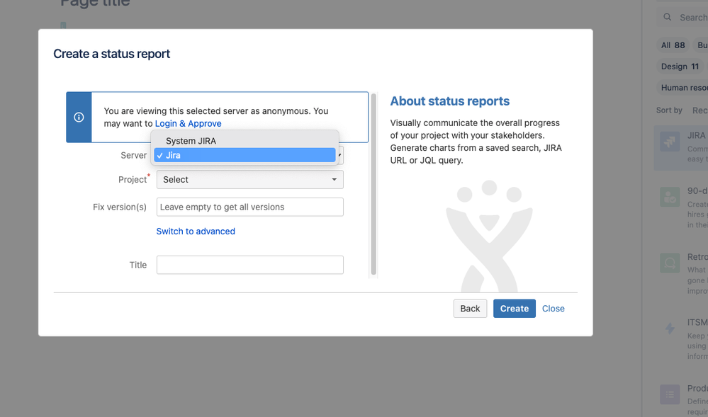

I was just testing adding an app link between Jira and Confluence on different sites, and wanted to create a Jira Report with issues from the Jira on another site.

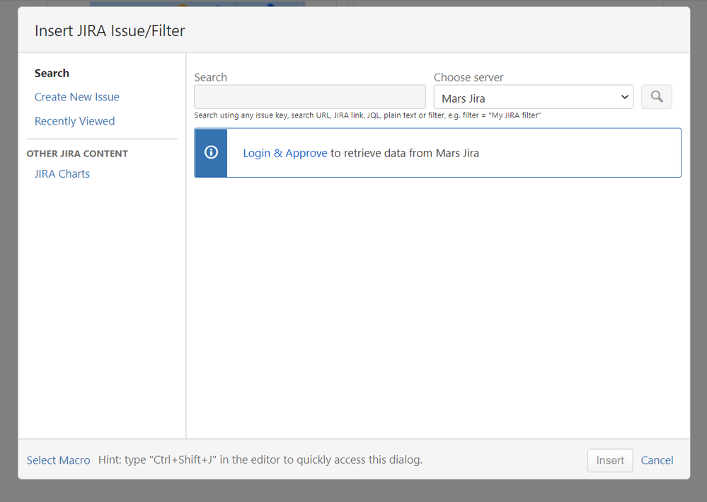

I am prompted to choose a server (and the options correspond to what is listed in my Application Links), but when I choose the remote cloud server, impossible to select a project. The Project field is empty, with the just the filter option (and I have one project on the remote cloud site, but searching for it returns "No matches found").
And that prompt to Login & Approve goes no where (nothing happens if I click on it).

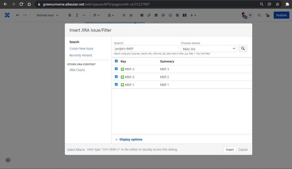

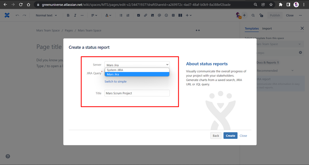

Hi @Julie d_Antin _Elements_
Here are the screenshots
Once you add the macro in Confluence, you need to log in
Once you log in and approve, here's the issue from another site

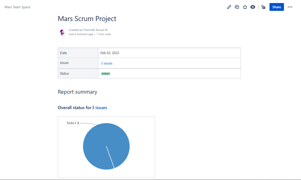

And the status report here
Let me know what issue you are facing
