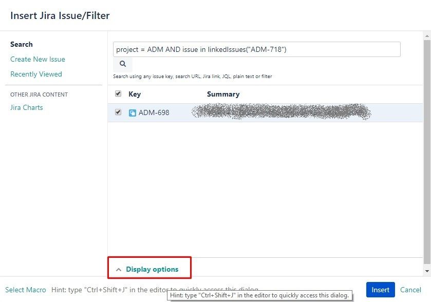

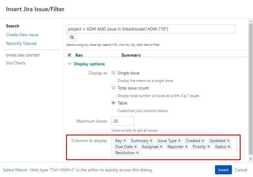

Hi @David Hazeel,
To tell you the truth I don't quite understand what you're trying to achieve. You have some kind of a filter, right?
Let me show you my example and how it works in my environment:
Display options1.jpgDisplay option2.jpgSo, as a result, I have this table:

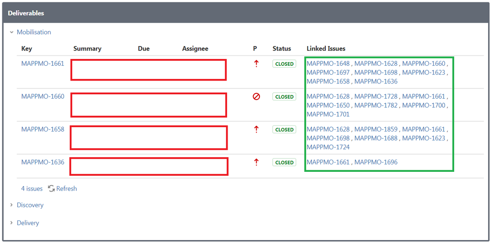

Grigory Salnikov
November 8, 2018
Oh, am I right assuming the following:
-  this is the result you want to achieve.

David Hazeel
November 9, 2018
Yes exactly that. Currently the macro generates that list in the green box and I'd like the status of the linked items to be displayed too.

Grigory Salnikov
November 9, 2018
Yes, I definitely see now.
The very first thing that comes to mind is to create 4 additional filters:
... something like:
1. issue in linkedIssues("MAPPMO-1661")
2. issue in linkedIssues("MAPPMO-1660")
3. issue in linkedIssues("MAPPMO-1658")
4. issue in linkedIssues("MAPPMO-1636")
 Yes, this is not the best but still, a way.

David Hazeel
November 9, 2018
Thank you - I've managed to get that to work so that it displays as a separate filter below the current macro. I'll accept this as an answer as it does solve my problem in a simple way.
If you can find something else, that would be even better. Thanks again for getting back to me.
