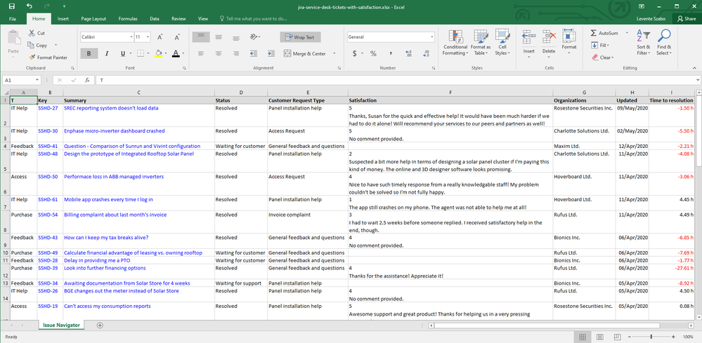

You could try this way: export your filter to Excel, then embed the resulted spreadsheet in the Confluence page.
The Better Excel Exporter app can export the rating only, or both the rating the customer satisfaction comment like this:
jira-service-desk-tickets-with-customer-satisfaction
