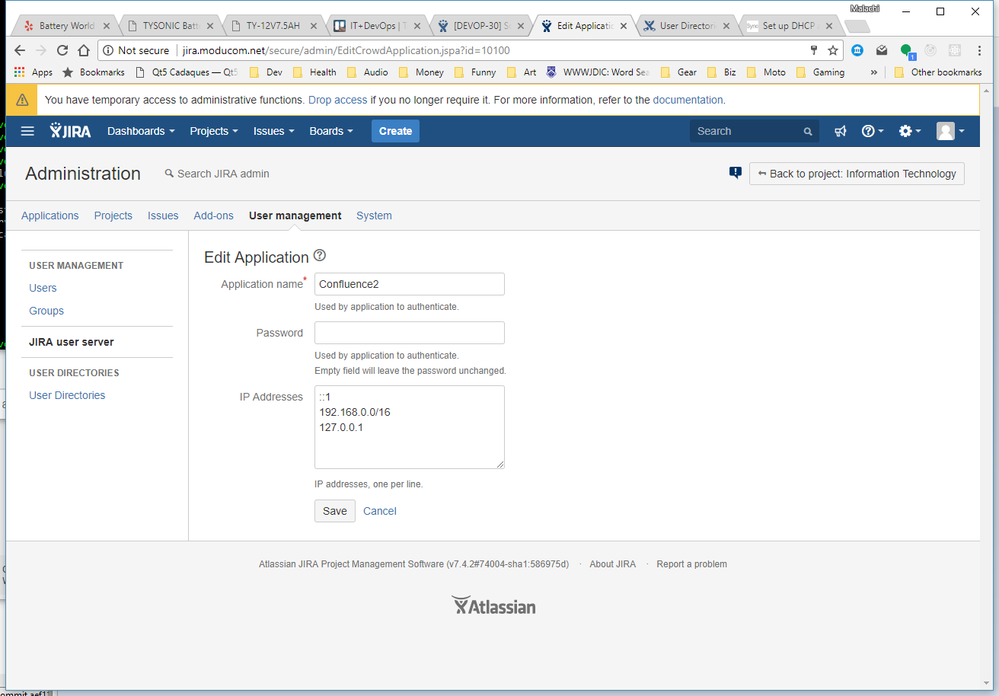

One more thing to check - since Confluence is also behind the proxy, the requests to Jira User Server may appear to Jira to be coming from the NGINX proxy. Is the IP address of the proxy allowed in Jira User Server and in the Jira Whitelist?
I am curious whether you have application links set up between Confluence and Jira and if so, whether the links are using the DNS names.
Malachi Burke
September 26, 2017

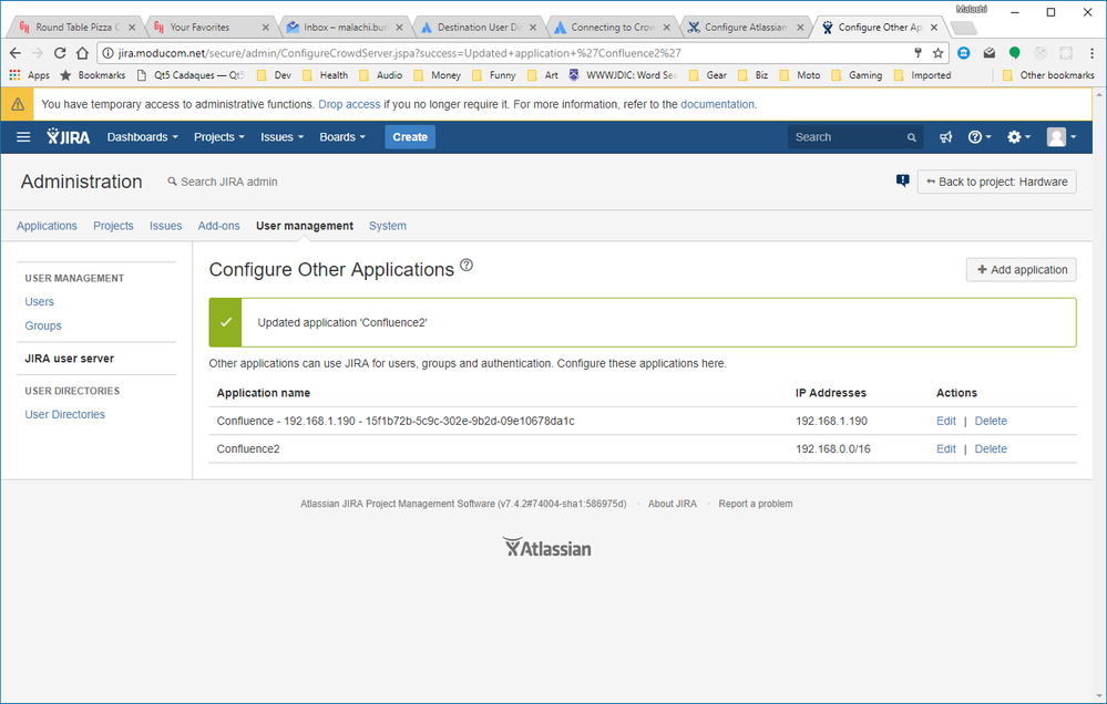

Application links on both sides using DNS naming without explicit ports.
Whitelist also using DNS naming; Going to add IP:PORT directly to Whitelist and followup with results.
EDIT:
Found the culprit.  The IP Addresses under Edit Application needed to include localhost-y things in it (::1, 127.0.0.1), not just 192.168.0.0/16.

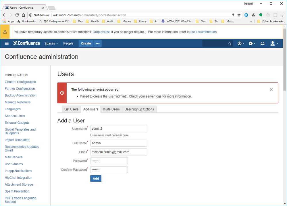

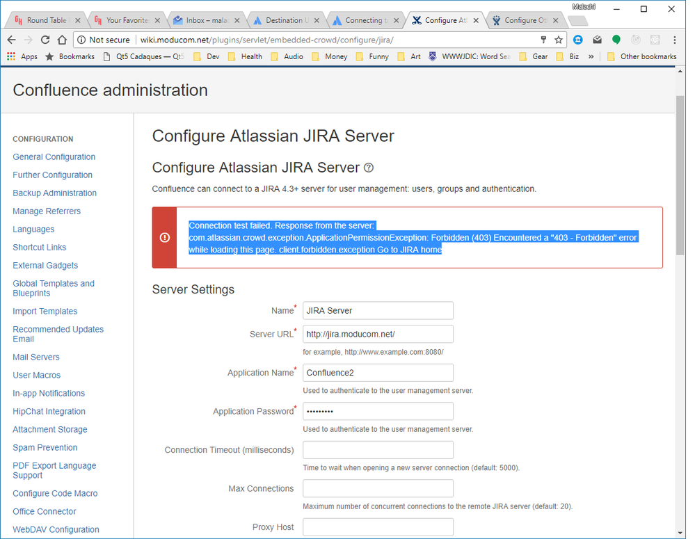

At the point where I try to "Add" "Atlassian JIRA" in the Confluence User Directory area, I get a :
'Connection test failed. Response from the server:
com.atlassian.crowd.exception.ApplicationPermissionException: Forbidden (403) Encountered a "403 - Forbidden" error while loading this page. client.forbidden.exception Go to JIRA home'
Even though I triple-checked that Application Name and Application Password match
Here are some screenshots:

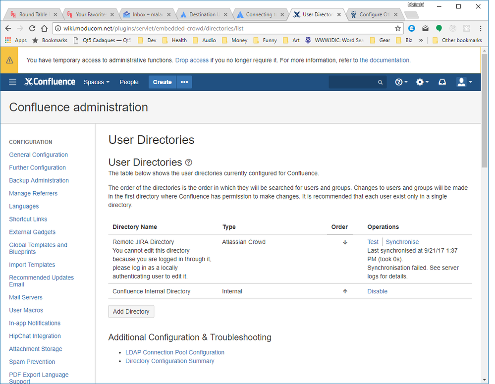

Thanks for the screen shots. Based on those:

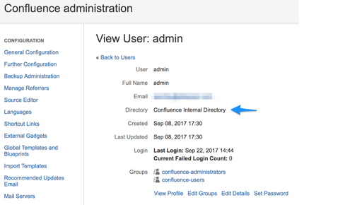

  • You need to log in with an administrative account from the Confluence Internal Directory so you can edit the Remote Jira directory.
  • Then you have the 403 error to overcome.
Internal Administrator
For logging in with an internal admin, go to Confluence Admin>Groups and check the membership of the confluence-administrators group. If you do not have credentials for a user in that group, then add a user (it will add them in the Confluence Internal directory unless the Jira directory is read/write)and add the user to the confluence-administrators group so they will be a super user.
Then you can edit the existing  Remote Jira user directory to point at the DNS name instead of an IP address.

You will likely see the same 403 error when connecting with the existing user directory that you are seeing when adding a new Jira user directory. To get connected, please see: Unable to connect to JIRA for authentication - Forbidden 403
Confluence server could not connect or access to JIRA server due to the following cause:
  1. JIRA does not include Confluence server IP address in JIRA User Server settings
  2. JIRA has not whitelisted Confluence server or IP address, despite both of them located within same server.
  3. There is a proxy or firewall that blocks such access from Confluence to JIRA.
Please try the resolutions from the article and let me know if you see any other error when connecting to Jira for user management.

For the Internal Administrator guidance, the account I am logged in as reports to being a member of the confluence-administrators group.  I am able to attempt adding remote JIRA user directories, as indicated in 2nd screenshot (Confluence_userdirectory_2)

Item 1
In the 3rd screenshot (JIRA_userdirectory_1) I have IP address specified of 192.168.0.0/16 to allow all traffic in from 192.168.x.x which does match our IP range

Right now the issue I am focussed on is the 403 error connecting to Jira, but I wanted to be clearer about the Confluence Internal admin. Regarding the editing of the existing Remote Jira User Directory: In order to edit it a user must be in the confluence-administrators group and also the user must be logged in from another directory. Your other directory is the Confluence internal directory. To see what directory a user is from, view them in User Management as in the screen shot below.
It is considered a good practice to have an administrative account in the Internal directory when external authentication is used with Confluence. That way, if the system that authenticates users fails or is unreachable you can still get into the UI.
