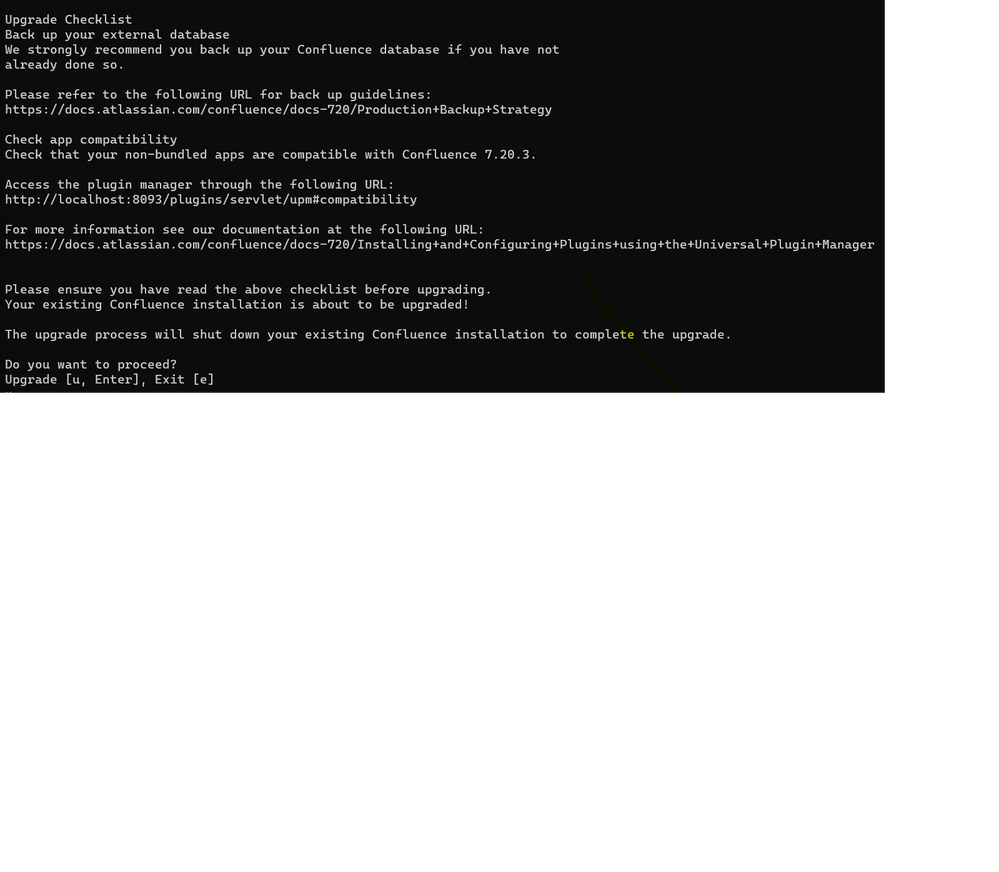

It seems that because my tunnel connector was the last uncommented connector in the list, the installer assumed 8093 was the correct port and it changes the port for you.
I will try re-ordering the connectors to see if that changes the behavior of the installer. I noted that before I told the installer to perform the upgrade, it thinks the url to check for app compatibility is on 8093. So this was just a case of the installer trying to be helpful I think
JJ Fullmer
January 10, 2023
I re-ran the installer without initiating the upgrade and when the tunnel connector isn't the last uncommented connector it doesn't give any link to check for app compatibility
  • With tunnel connector listed as final connector:image.png
