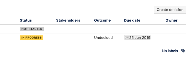

Using the decisions template I'm unable to have @ mentions mirror in the decisions log. Did the decision (log) template break somewhere along the way? I decluttered the template a bit but it doesn't appear to have been working before that.
Even when adding stakeholder in the first step of using the decisions template it won't populate the stakeholder column below.

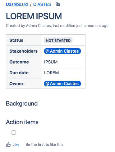

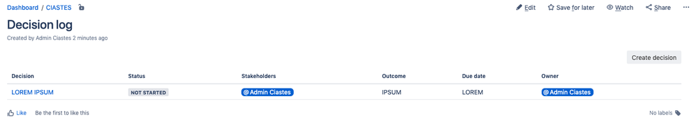

Hello there!
This is a strange situation indeed, Stefan. I tried to replicate the issue locally but, I was ultimately unable to. Everything worked according to plan.
Here I have two screenshots of that:
Screen Shot 2019-06-25 at 14.06.13.pngScreen Shot 2019-06-25 at 14.06.21.pngFirst thing we can start checking is if the Row Name was not changed in your Decisions page. By default, the row we are talking about is called Stakeholders. If the Decisions page does not have this, no value will be shown in the Decision Logs. For this, we will need to edit the page:
  1. Go to the Decision page
  2. Click Edit
  3. Check that the table has the Stakeholders row
  4. If it does not, include it
Further, on the Decision Log page, we can check which columns the Page Properties Macro is looking after. To do this, we will need to edit the page as well:
  1. Go to the Decision Log page
  2. Click Edit
  3. Click the Page Properties Report macro
  4. Click to edit
  5. Click More... under Options
  6. Check the values under Columns to show

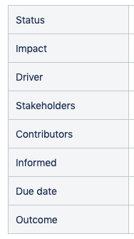

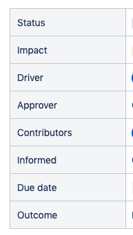

Nik above is right. The default Decisions template doesn't start with the right labels.
Here's the default rows available in the template:
I changed "Approver" to "Stakeholders":
And now it works on the Decision Log Display.
I agree that an update to the default template should be made to avoid this kind of confusion.
