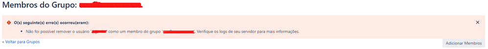

3 - When I try to remove the user from a certain group, the system returns the following error.

Hi @Tribanco and welcome,
probably there's an overlap of username through User Directories.
For example, you have two directories : DirectoryA (first position) and DirectoryB (second position). There is a user with username that exists in both directories but in DirectoryA is active and in DirectoryB is not active. If you change directories order, that user will ttake info from DirectoryB and it will be not active.
Moreover, you can't change user status because DirectoryB has been setup as read-only.
Hope this helps,
