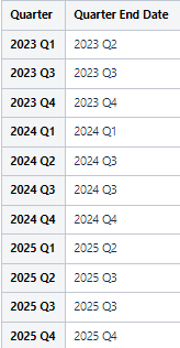

sorry, i am using this but results look different. i have the date format as yy Qi too. what seems to be wrong please?
SELECT T1.'Quarter' as Quarter ,
FORMATDATE(DATEADD(day, -1, DATEADD(quarter, 1, T1.'Quarter')), "M dd, yy")
AS 'Quarter End Date',
Seems that your version of the Table Filter, Charts & Spreadsheets for Confluence app may be an outdated one. Please ask your Confluence administrator to check and update if required.
The current version is 11.2.0.
