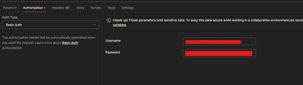

we have an app that you can login to your jira account and use it to create issue directly into jira using the cloud rest api the login process is done through the base64 authorization parameter
so what i understand is that we cannot use the custom domain to call endpoint?

Ok that's postman.
You should not be using /secure/QuickCreateIssue!default.jspa?decorator=none&pid=10033&issuetype=10035 for that. This is not meant to be used outside of the user interface.
Just as a test: can you use this with the custom domain?
{custom-domain}/rest/api/3/issue/{issueIdOrKey}. HTTP method is GET
