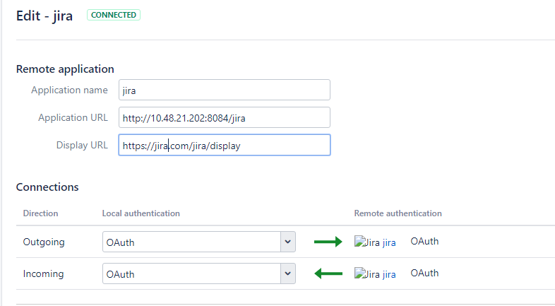

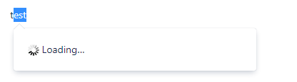

I've successful linked confluence and Jira (OAuth connection for both), however i can't create Jira issue from confluence the marco still Loading and no Jira project appear.
Both application are hosted on the same server, they listen on different ports, and they are both reverse-proxied via IIS.
The application links are set up via the added connector port numbers and the display URL is configured to show the proxied URL.

Hi @Mahdi Challouf
I will look at the logs of both applications to see what’s going on when you attempt to create issues.
Also does the JIRA issue macro for loading issue in confluence work? If this doesn’t it could be related in which case, starting at your logs is most important.
Attach the logs over if you do not have an idea what to check for.
