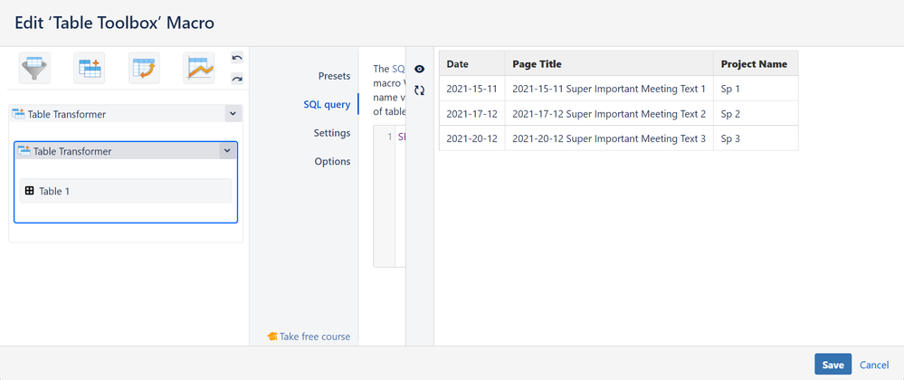

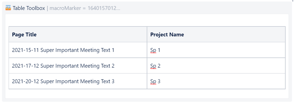

I assume you have the following case:

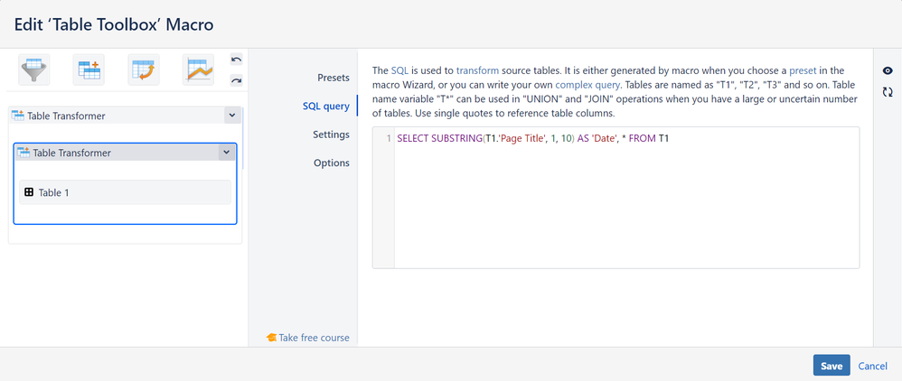

SELECT SUBSTRING(T1.'Page Title', 1, 10) AS 'Date', * FROM T1

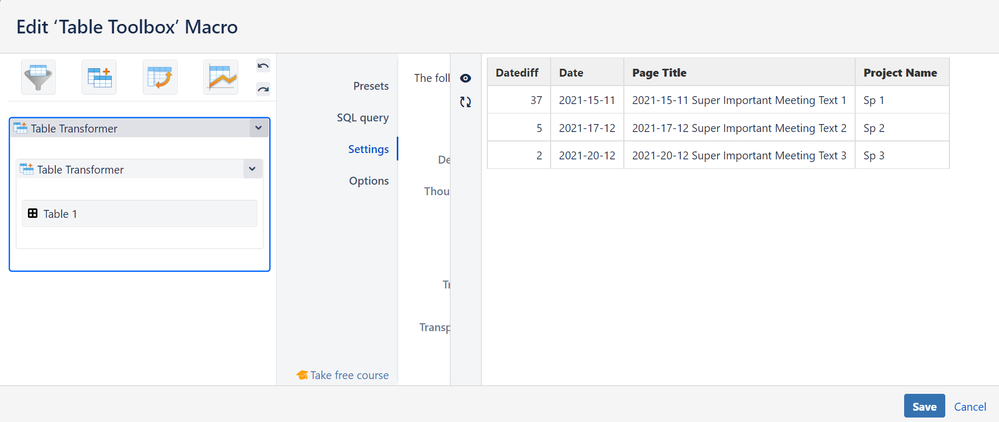

Now your date is a string and the simplest way to perform any manipulations with it as a real date is to use another Table Transformer macro with a correctly specified date format:

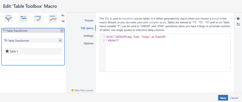

SELECT DATEDIFF(day, 'Date', "today") as 'Datediff',
* FROM T*

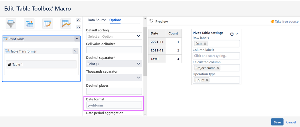

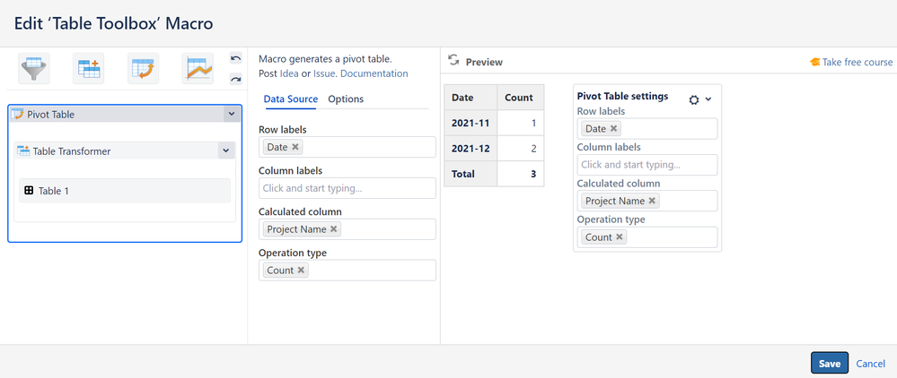

And if you want to use other macros on top of the first Table Transformer macro, then you also don't need to convert the dates, just choose an appropriate date format in the macro settings.
Here is an example with the Pivot macro:
Hope this helps your case.

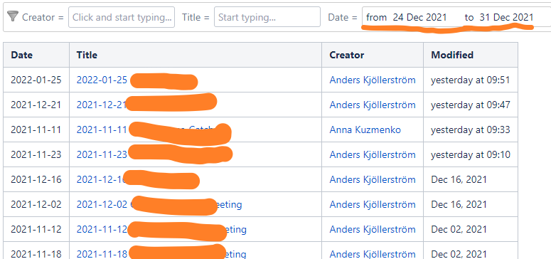

Yes, your assumption of the start of my case is correct, but my issue is slightly different.
My problem was that when applying a filter to the column, the date column did not respond to filtering, I assumed wrongly that this was because it was not defined as date format.Filtercase.png
While playing around with it a bit further, I've found the solution. Putting it here for fellow rookies :)
In the picture you can see that the date format is different in the date column and the date filter. I just had to change the date filter format to correspond to the column format. It can be done temporarily directly in the user view of the table or (better) permanently here:
I'm still in the dark as to why the filter differentiate the different types of date format. To me they all represent the same date value in the end. This seems to be more of a fundamental difference from my previous experience (i'm old), maybe it is just an effect of trying to make the administration more user friendly and not relying on administrators having coding experience? Could you @Katerina Kovriga _Stiltsoft_  or anyone else point to some reading explaining this on a dummy level?
Anyway, main problem solved, thanks!
